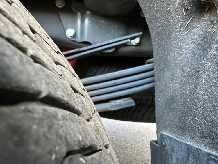

I may be using the wrong terminology, but by “overloads” I meant the separate leaf spring above the main spring pack that engages its own set of bumpers on brackets bolted the frame. There was quite a bit of discussion about the 2500 not having this spring and not having the frame mounted bump stops for it. A person was wanting to add that spring and the bumpers to his 2500.
On 9/25/2023 at 9:20 AM, Pryme said:
So they both have a four leaf pack and both have overload spring but slight differences. I know my 2500 has five total leaves. I mean there has to be some  difference to account for the 500+ pound payload increase the 3500 sees.
From my research and from what newdude said, the 5 leaf spring packs are identical in the 2500 and 3500 trucks.  The only difference is the 3500's get the 2 extra springs above the spring pack and the overload bumpers for them.  Those 2 extra springs are what increases the payload over the 2500's.  I could be wrong as I've been before, but my research says I'm right.
59 minutes ago, Another JR said:
There are multiple part numbers of rear spring packs. Remember that thread?
You are correct.  Most of the differences that I've seen include the overload springs that are attached to the "basic" 2500 springs.  Then we get into the long bed springs vs. the short bed springs.  They also have different Part numbers for reasons unknown to me.  But getting back to the basic 2500 spring pack, that's what I'm referring to.
