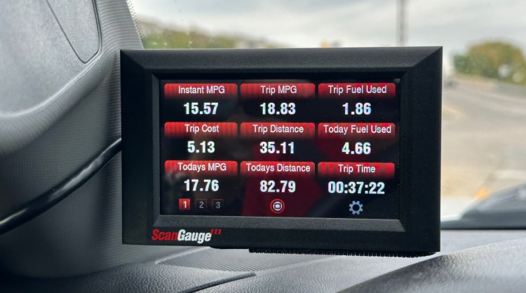

My last truck was a 16 tundra owned it for over 5yrs. Tundra got only 1-1.5mpg more in most situations. Sometimes it’s just splitting hairs. I watched both closely on trucks display and both with a scan gauge.

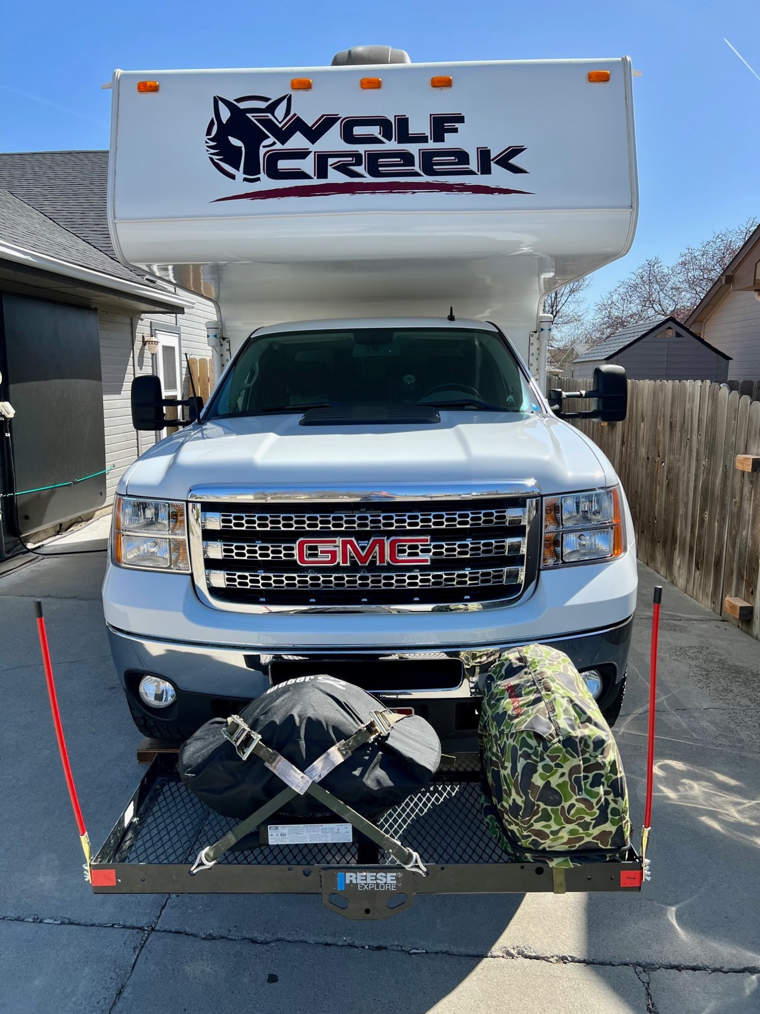

No truck campers in that thread but a few of us with this combo have chimed in there.  I've really grown to love my truck.
