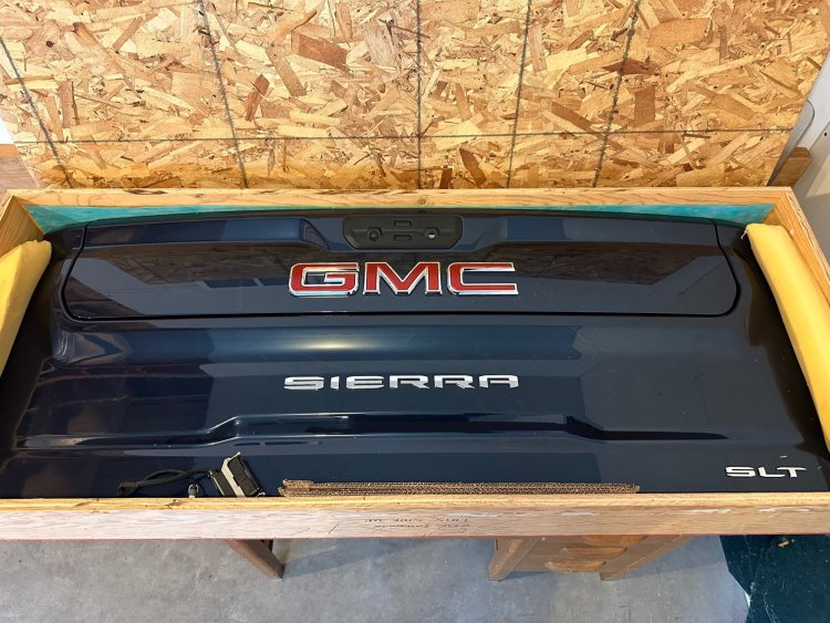

I load and unload my Four Wheel Campers pop up slide in camper about three or four times a year. If I am going to have it off the truck for only a month or two, I just drive the truck with no tailgate unless there’s some hauling that requires it. My tailgate mostly lives sealed in the padded crate except for the long winter stretch when I have the camper off from late October to early March.

Hi Grumpy Bear, diyer2 and Another JR - thank you for your responses!  Very thoughtful and helpful.  You convinced me, I will remove the tailgate.
Another JR - that crate is impressive.   I suspect your garage is more organized than mine!  The best I can do when I remove my tailgate is to lean it against the wall with a piece of foam underneath and hope that the kids don't knock it down at some point.  :)
