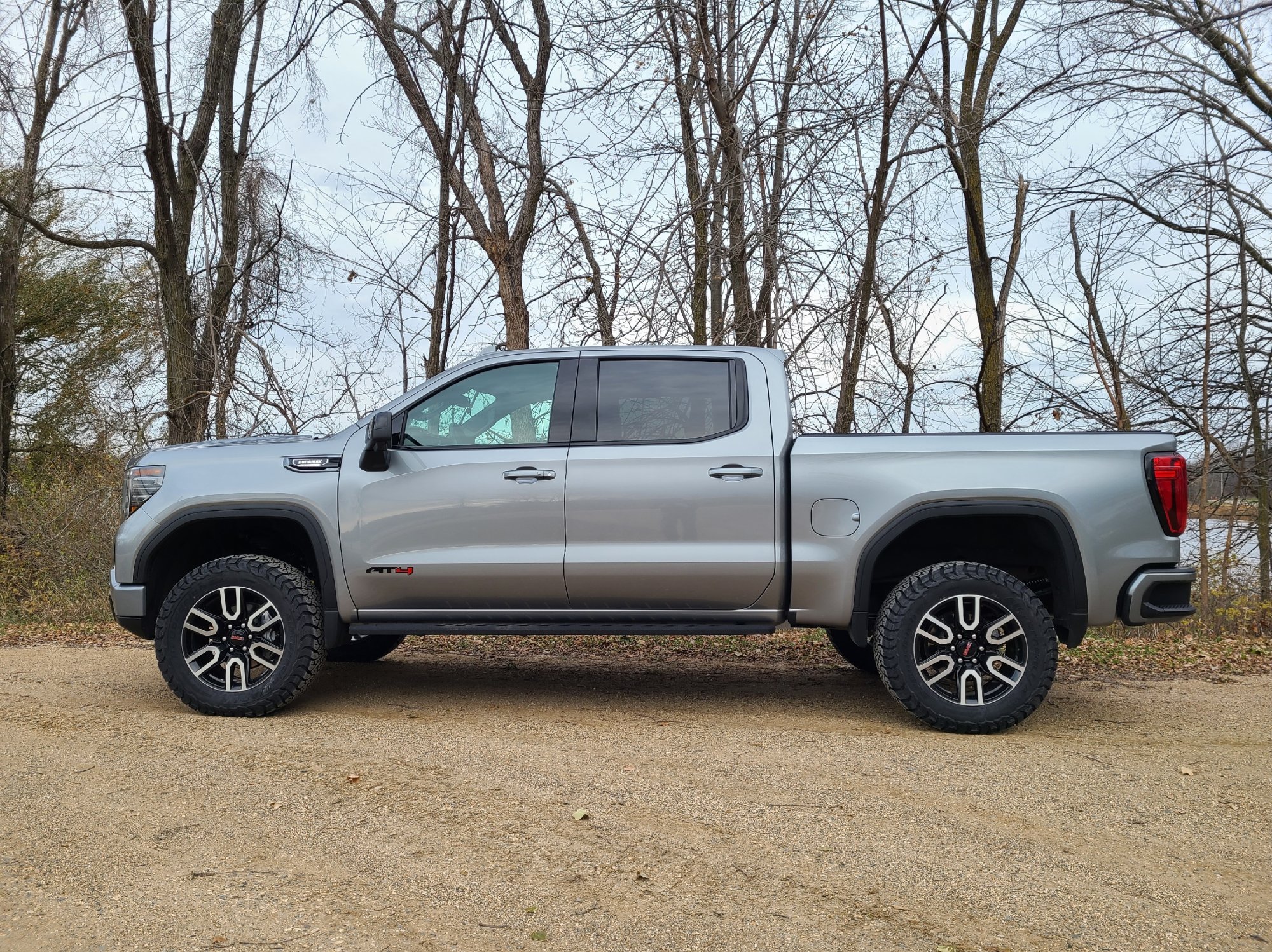

I just had a set installed on Tuesday and the price difference between the KO3 and KO2 was negligible (~$430/ea) so it wasn't a difficult decision to just go with the KO3's.  I went up a size from the OEM 275/60 Goodyear's to 275/65.
What do you think of those tires so far? I'm looking at those exact tires. Do you have any more pics from different angles?
I don't have many miles on them yet, and nothing off-road or on wet pavement to see how they compare to KO2's.  Hope to get on some trails next week but there hasn't been any snow yet either to see how they work in that.  I'm looking forward to getting some snow to try them out!
The only thing I noticed right away was that the tire shop put 35psi in them and it made the truck wiggly/squirmy at times on the highway if you laterally crossed over a seam or a crack in the pavement.  With the factory tires at 35psi my truck never acted like that so it was very apparent something was off when first driving with these tires.  Almost like you had crab steering or one of the wheels was loose.  I filled to 45psi when I got home and now the truck tracks normally.
