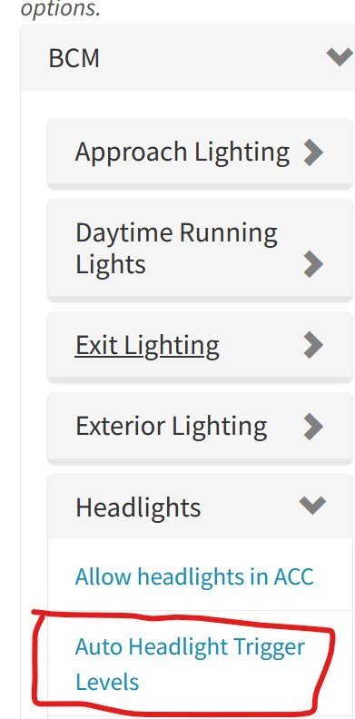

If BT Diesel and the Autosync dongle for the OBD are connected (technically, The OBD dongle doesn't need to be connected but does for an update), log on to your computer and change the settings for the auto lights on as far as light input into the sensor on the dash. Then, (plug in the OBS dongle) go into your Autosync settings in your truck  and update the tune.
I have mine set to a sensitive setting in case of clouds and potential rain.
I'm sure your truck has the light sensor on the dash?
After any changes, your Autosync can be disconnected unless you want to use some of the features in the OSB dongle unrelated to your truck settings.
Also, always make sure you're receiving the latest updates through the Autosync settings on your trucks infotainment system.

What setting did you change? This issue is only within the last few days and no settings have been changed within that timeframe.
Here's a screen shot of the hierarchy to the setting:
Edited by MikeBMW
