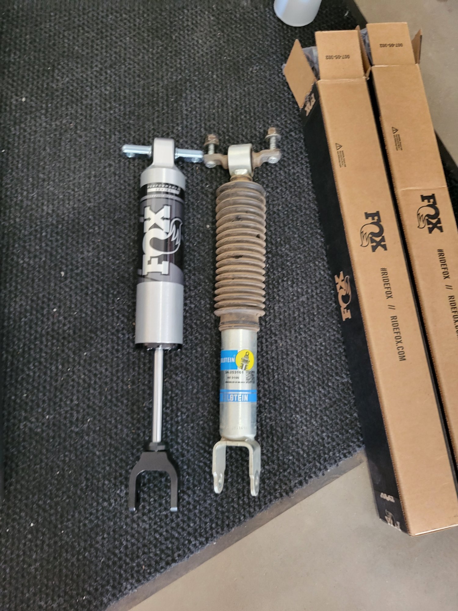

Which way did you mount your rears? Everything I'm reading says Fox prefers body on top, shaft down. I just got my HTOs in and I'm ready to put them on. I bought the 1.5-2.5" lift variety due to the ZR2 mods.
Great question.  I didn't even think to check the position as I installed the new shocks the same way GM installed the stock ones.  So I have mine body-down.  I thought it was odd, but i figured GM engineers were smarter than myself. lol

Sorry for going dark for the last few months.  Ive been traveling a lot for work and haven't had a lot of free time.  I finished my suspension work and wheel install roughly two months ago and have maybe 100 miles on the truck since.
Fox shocks mount shaft down.
I "upgraded" my HTOs to Accutune tuned Fox 2.0 reservoirs. The HTOs are for sale for anyone looking.
I'll make a good deal on them
Edited by kylant
I'm going to try the Fox way. I'll report in if something weird happens.
Apparently, their reasoning is the steel shaft being more exposed at the bottom has less chance of a damaging impact that could cause a seal leak compared to the aluminum body. This is probably more for off-road trucks than hiway trucks, but that's their game.
That makes sense.  I didn't think about it as I was dealing with heat exhaustion while working on my truck and just put them in same the way the crappy stock Ranchos were.  I'll change mine around one of these days.
