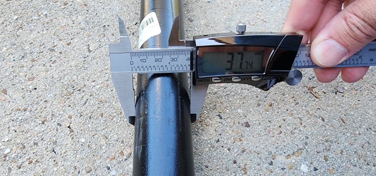

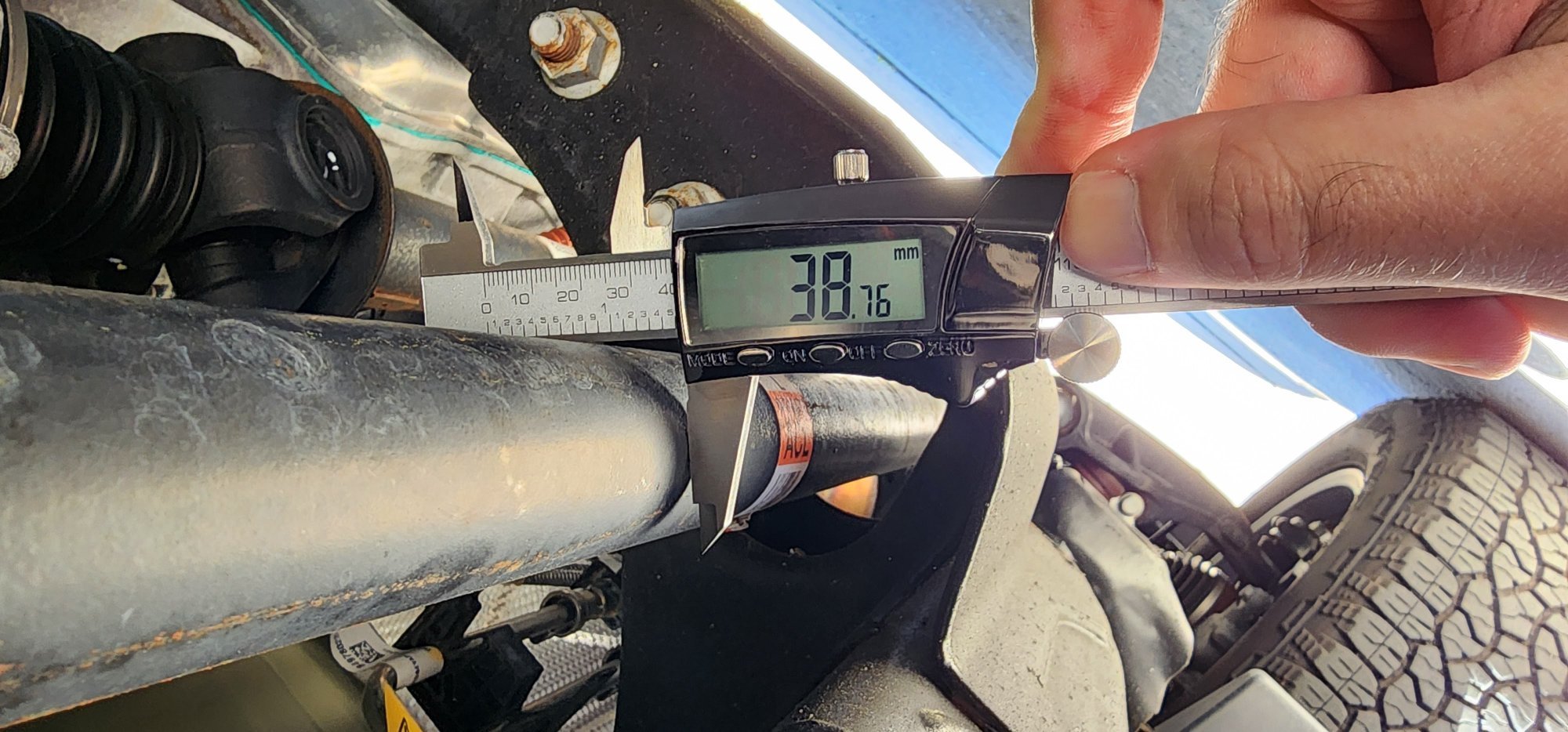

On 3/17/2025 at 10:58 AM, GMCnewbie said:
Confirmed that my truck has the 4,800lb bars installed.  I took photos of both the Cognito and stock bars.  The Cognito bars only had a single sticker that was wrapped around them.  I had to take 3 pics to get the whole thing.  The Cognito bar is 1.02mm smaller than the stock bar.
I finally found a 4,400lb FAWR truck. Verified by door sticker.
When fully closed, this indicator is off by .0035. So the actual measurement is approx. 1.4865" or 37.757mm.
I measured fairly close to the sticker like newbie did. Unless these bars have graduated thickness, and given the likely error tolerances of our instruments, it looks we may have an answer?
You should be able to rotate the 'face/bezel' to zero the calipers when it's closed.
One of the locking screws locks the caliper, the other is for the face.
Isn't that amazing, I mean a complete fluke that Cognito by mere coincidence just happened to make their "special" torsion bar set the same diameter as a certain GM torsion bar which also happens to be the smallest diameter bar GM makes for these series of trucks.
So was a price of a Cognito bar vs a GM bar set ( go with US prices ) get established to compare ?
This also then goes back to my watching a youtuber in Texas who had a Duramax and his truck I believe would have had the 5600 lb rated factory bars and he installed a set of the Cognito bars ( which now with this info are highly likely to be the 44000 lb rated bars ) and he raved at the ride as did him claiming his wife was blown away and questioning what had he done to the truck to make it ride way better. Shows what happens when a softer bar is installed in a front end heavy diesel truck and turn the keys more to get the same ride height back.  Hard to say how much of a noticeable difference there is in a gas truck that has the 4800 standard units and dropping to the 4400 bars, it would be something but I assume not drastic.
