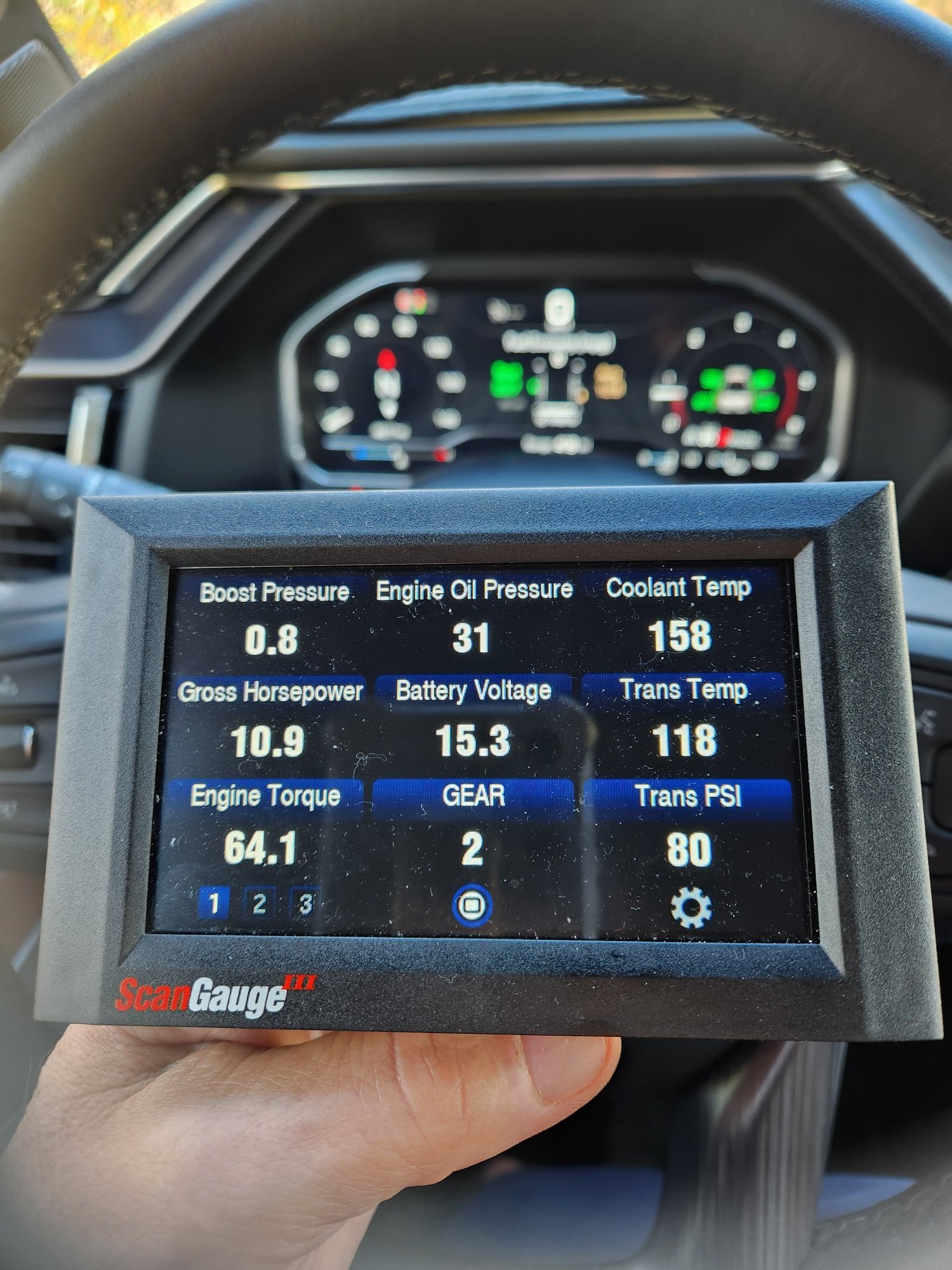

Got this put in the SG-III this am. Call it "Trans PSI". Reads 80 PSI in Park at 650 RPM. Got up to 218 PSI at 1500 RPM in Park. This at 158/160 Deg. on Eng. Coolant, and 118 deg., Trans Temp.
