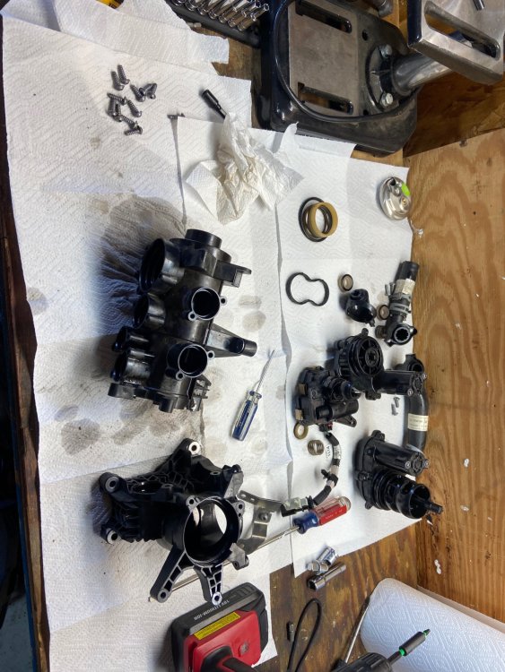

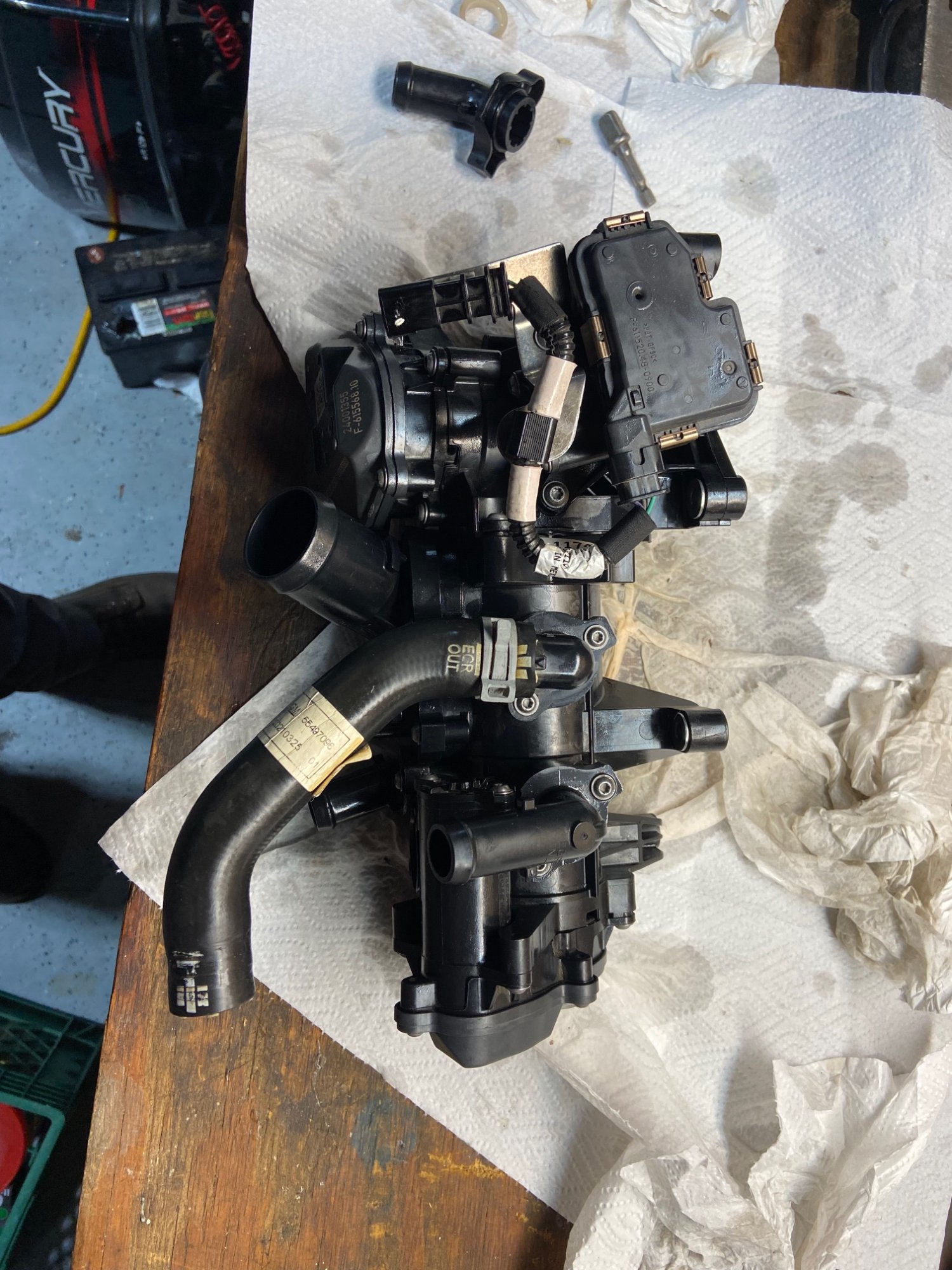

Hello Friends,   on Friday I removed, cleaned, lubricated and reinstalled my coolant control valve (24001355) on my 21 Sierra (68k miles=no warranty).  It was a success and I no longer have fans blasting or engine light on.  The issue was was in the gear box to one of the valve motors…it’s the one with the steel clips instead of screws.  It was all gummed up and badly needed cleaning.  I used a white lithium grease to re-lubricate the plastic gearbox.  It is a 7 hour job minimum but I accomplished all in my garage without a lift on just a jack stand. (Lots of car yoga though). Saved about $500 in parts, 5 months of waiting, and whatever the dealership would charge hourly.
Edited by flyfisherholms
Add pics
  • Thanks 1
