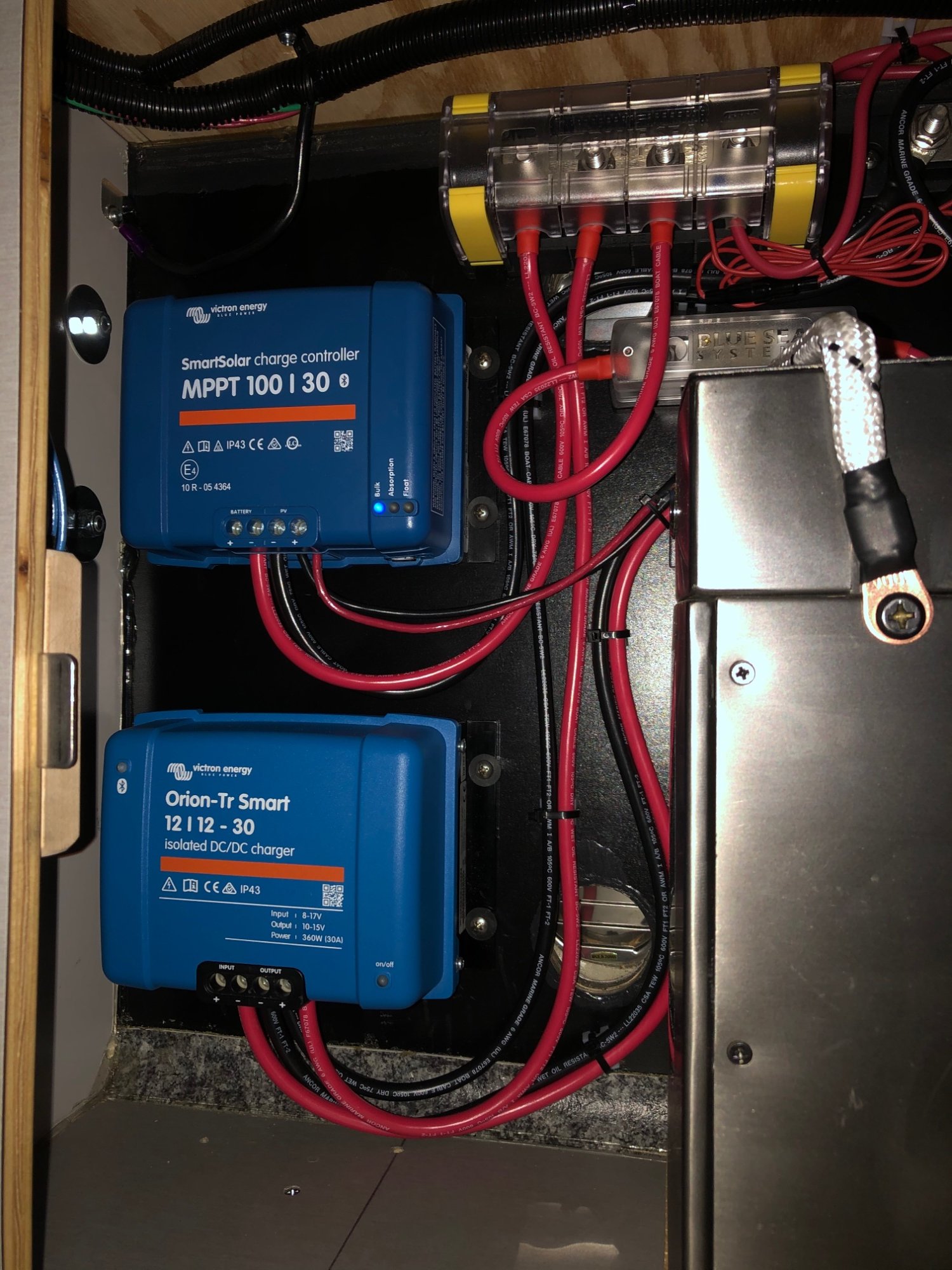

I second what Mike wrote. The maximum a 30 amp (output) dc to dc charger like the Victron Orion 12/12-30 will draw from the truck is about 35 amps. Your 170 amp alternator has quite a bit of excess capacity and should handle that with no problem as long as that is the only power connection to your trailer other than running lights.  If I was going to pull 50 or 60 amps I’d be thinking of installing the 220 amp alternator but it’s not needed for 35 amps.
I have a Victron dc to dc charger for my lithium camper battery and really like the ability to customize the charging parameters and control charging from an app on your phone.
