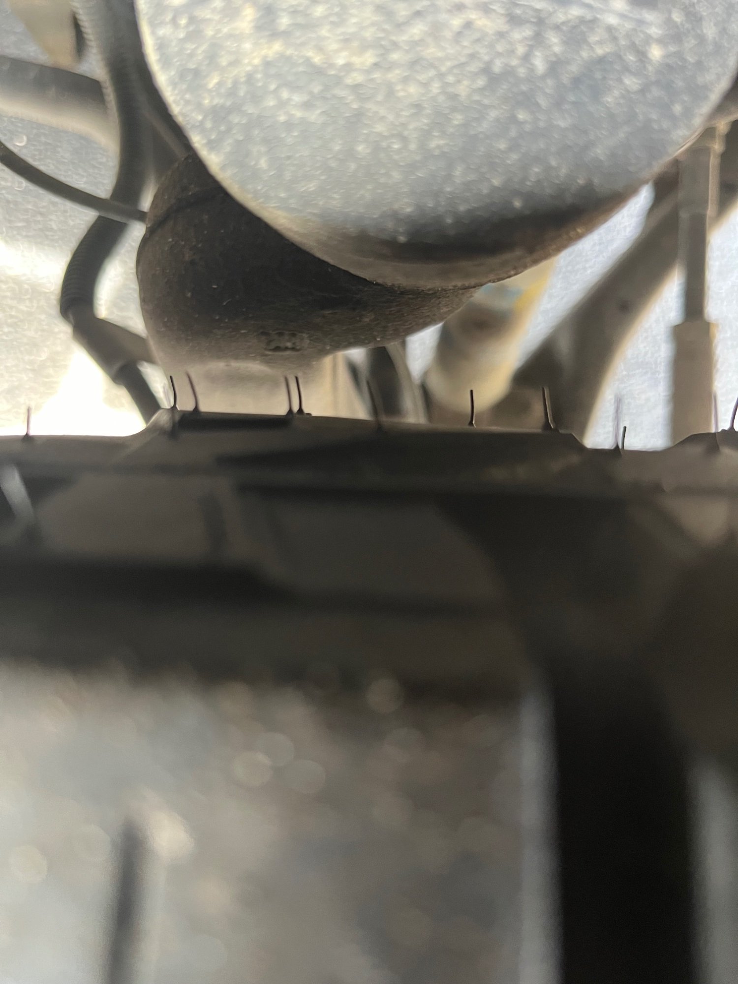

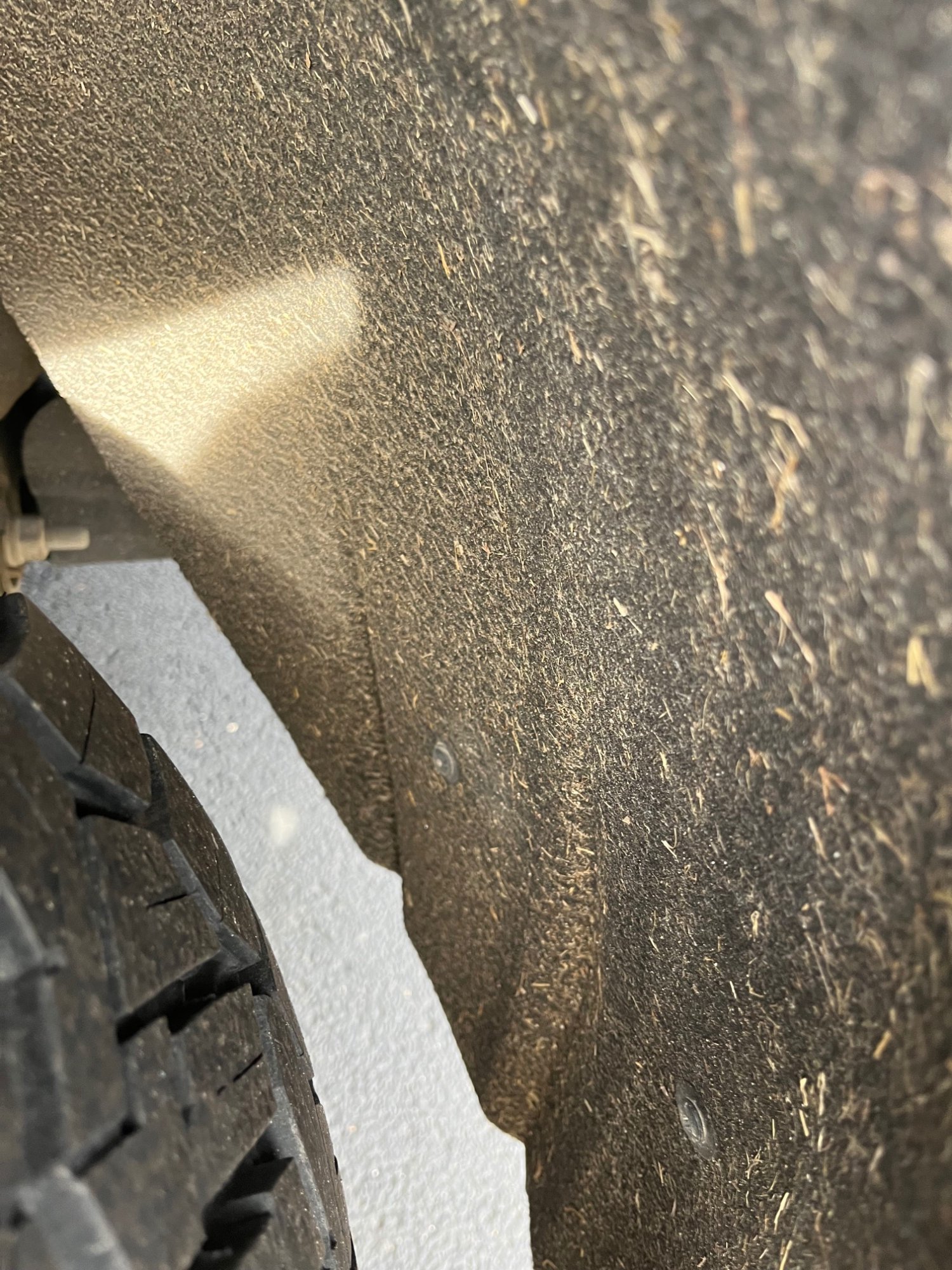

I do not feel like an idiot because I know what I am talking about. You keep speaking to me like I don’t. I know you keep saying it is only a 5% increase but on a non at4 or Trailboss truck it will rub.  The reason the example you gave factors in to the 20” being taller is the width of those tires are 245mm so they would be the same width. The sidewall height would be 147mm (60%) of the width. So yes if you add the 147 mm side wall to a 20” wheel vs a 17” wheel then the 20” wheel and tire would be taller. But your statement of the wheel being the same so it has to fit is not correct. And yes you said you went from a 17” wheel and tire to a 20” wheel and tire which yes was bigger but again is the stock size. If the op had an AT4 which he does then the tire would fit. But on his stock truck it will not fit with out rubbing.

Yes! You have missed ALOT!!!  You have missed the fact that the 275/60R20 you went to is the stock size he has. Regardless of how much bigger it is than what you had it is still his stock tire. You have also missed that you yourself have said the tire he wants to go to is 1.12” taller or .6” on either side. You have also missed that I put the tire size he wants to put on his truck on my truck and it rubbed. You missed that I had to lift the front of the truck 2” and modify the fender liners to prevent rubbing. Also what you have missed is the 255/70R17 tires you had previously measured 31.09 inches tall and the 275/60R20 you went to measure 32.99 inches tall which is a difference in height of 1.9 inches not the 3 inches you have been claiming. Yes the wheel is 3” bigger but the combo is not. So again I suppose you can continue to argue with me or you can acknowledge you have NOT put the tire size on your truck that he asked about and acknowledge that I may know what I am talking about because I have in fact done the very thing he is asking.
