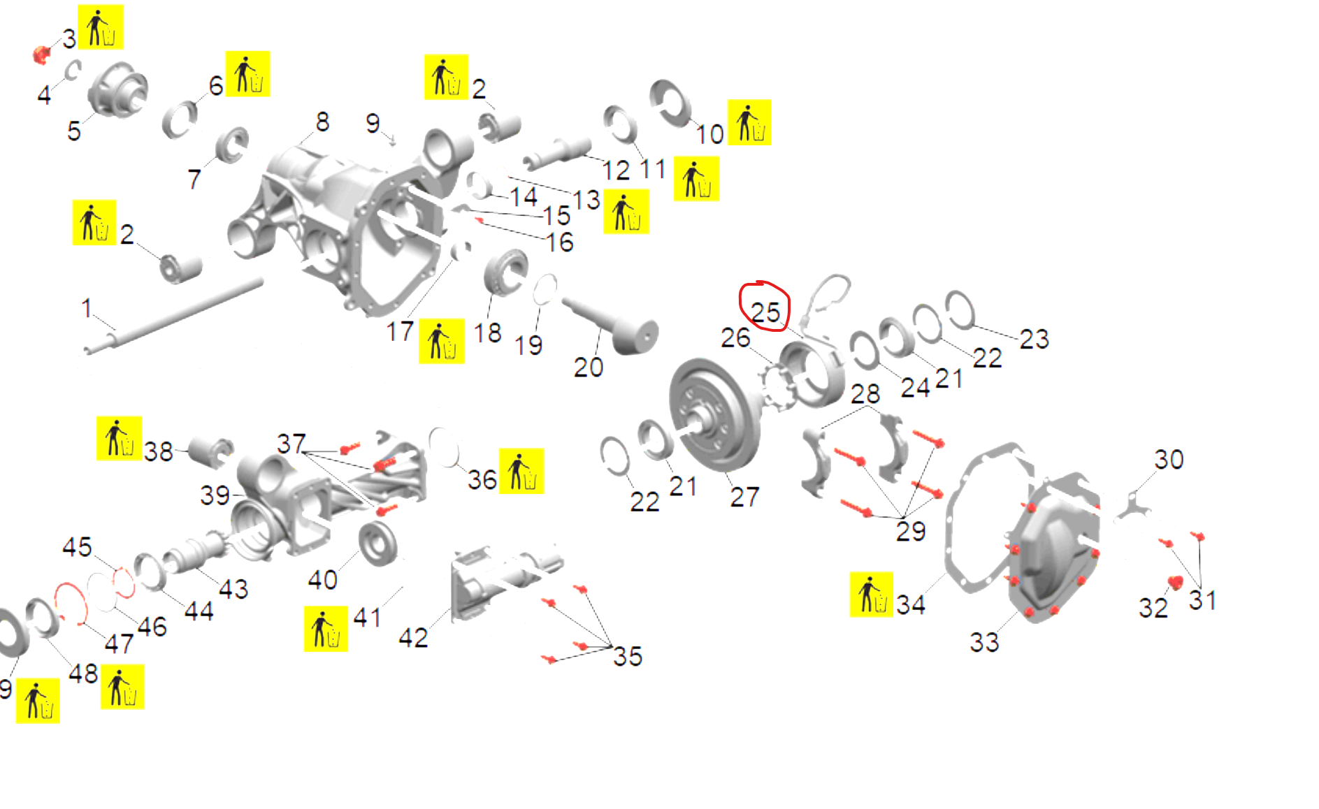

You should be able to easily bypass the BCM.  The BCM is only needed if you want to integrate it with current control knobs in your vehicle.  If it only needs a 12V power supply and a switch to activate it, you can run that directly from the battery, and back to the battery via an auxiliary switch.  I'll look up the wiring diagram and see what I can find.

Part Number 25 is the Electronic Locker.

So it basically looks like a power supply that runs to the differential, and then back to the Chassis Control Module to go to ground.  That appears to be a simple circuit you could wire directly from the battery, to a switch on your dash, and then to a local ground, bypassing any control module all together.

Upon my research I agree. Shouldn't be that bad at all
