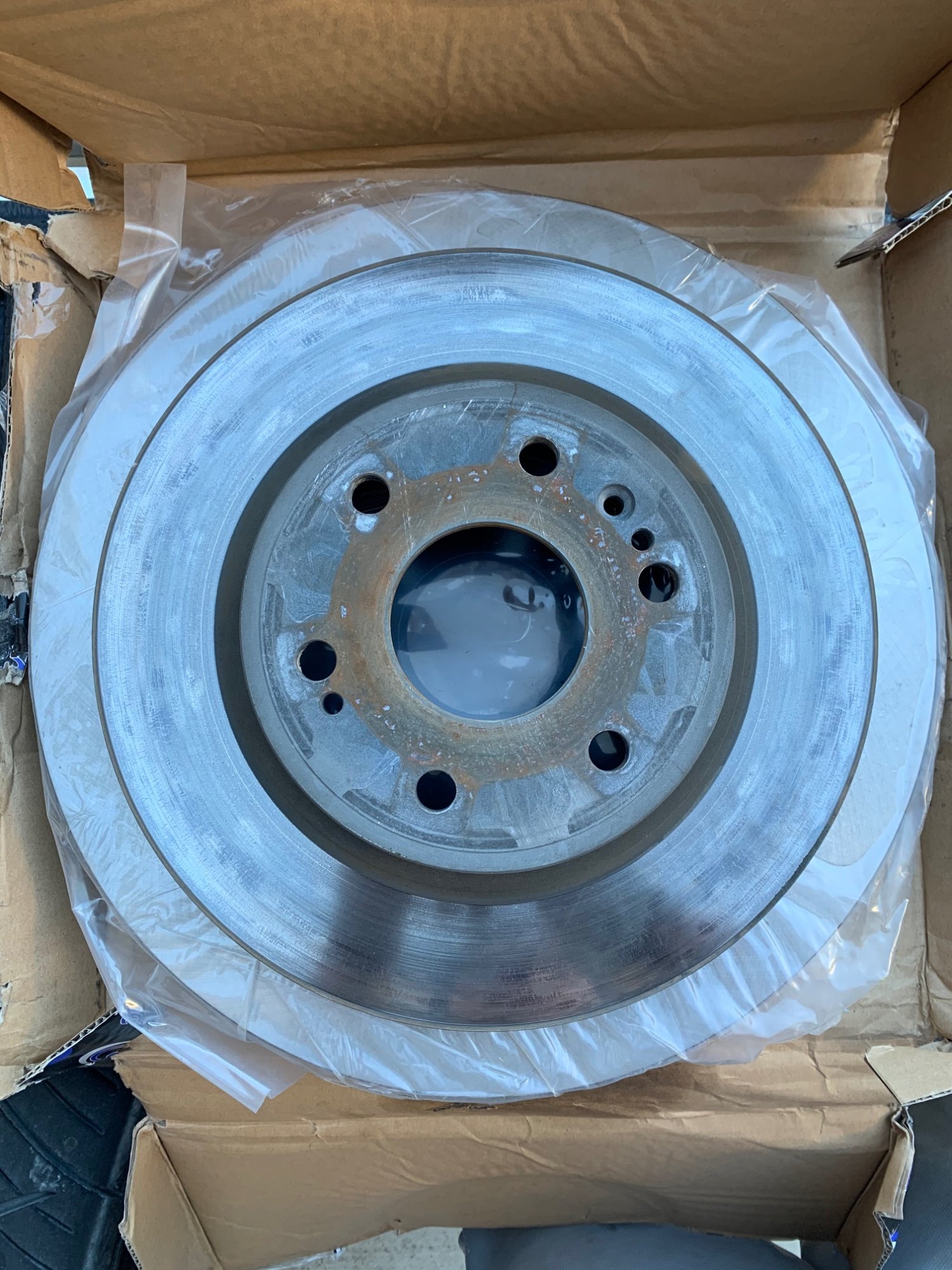

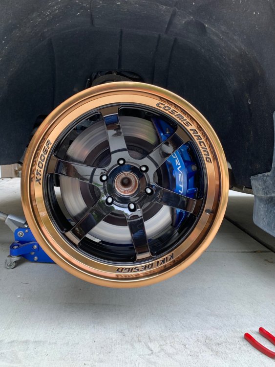

Yes. The 19+ calipers fit with the larger rotors. You just have to shim the caliper to center it over the rotor. I’m actually doing this swap on Saturday morning. Check marketplace for the calipers. I scored some new take offs from an Escalade because they upgraded to the brembos right on the lot. 2019+ are 4 piston, while the brembos are 6 piston. I got brand new loaded calipers front and rear, the front rotors and the dust shields for $170. You can’t beat that for a 4 piston big brake kit!!
