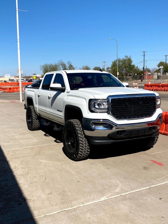

I have a 2017 Sierra 1500 5.3 4x4. I just picked up the truck today after getting 4.56 gears installed. I noticed my speed on the dash is about 15mph faster than my actual speed, according to the speed app I was using. How do I get this recalibrated?
