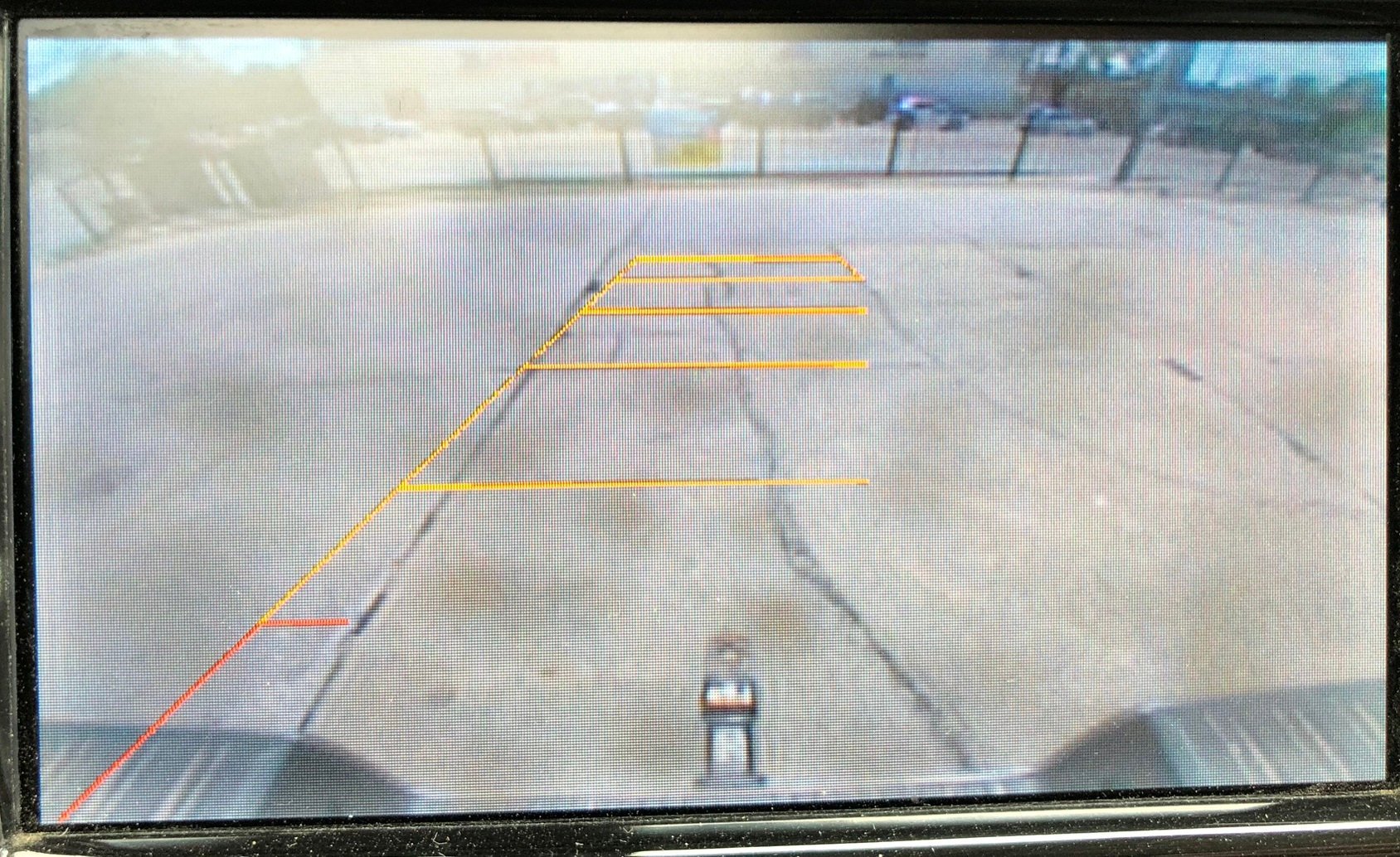

I ordered a kit from MVI, they had everything I needed all from one place. Works just like factory for the most part. Still sorting out an issue with the grid lines, currently I just turned them off.

Have you figured out the grid line issue I added a backup camera and mine is doing the same
No.
MVI said they have never saw this before. The grid lines and the way they display is all in the HMI, has zero to do with the camera. The only suggestion they could offer is trying a different HMI. Some back and forth shipping would be involved swapping it out. I asked about estimated costs and downtime to dig into this further and didn't hear anything back.
