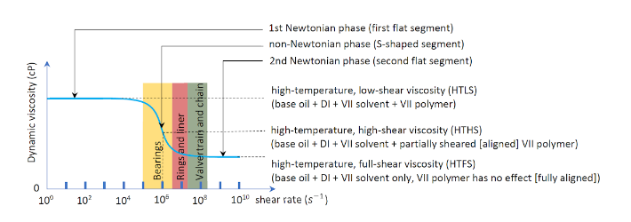

Not all Red Line HP oils are high SAPS. Look at the Euro line. Mid SAPS and the 5W30 is Porsche C30.
Food for thought.
When you build an SAE 30 from a Group II or PAO, what is the HTHS/HTFS viscosity based on? A Newtonian fluid that is also the same viscosity regardless of shear rate and only dependent on temperature.
How about when you build a 5W30 on a Group III/III+ on a 2 to 4 cSt base? HTHS/HTFS is based on the POLYMER which dies under shear. Especially above the HTHS shear rate.

I believe there was 48,000 mile 2.7 V6 Chrysler that ran a  PAG ( water soluble) formula very like the 1940's-50's Union Carbide formulations that contained 0.1% or less of Sulf ASH, NO VI, that ran one oil change to 100,000 with no issues but some corrosion from lack of specific additives geared to the modern engines. OSP solves all those issues but its $$$$.
Are we getting the point yet?
The above is what happens in a modern multigrade oil. HOWEVER in a No-VII oil or conventional straight weight the viscosity represented by the HTLS is the same as the HTHS and HTFS and HTUS. The trade is low temperature performance over a mineral single grade but not necessarily a naturally high VI based narrow range multigrade. Bottom line is temperature is the only modifier for a No-VII/Mineral single weight. HUGE viscosity thus WEAR advantage.

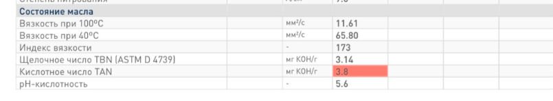

On the Russian Oil Club site, their UOA results generally show TBN, TAN and pH.
Here are two where you can see Red Line goes acidic.  It's said due to the high POE.
