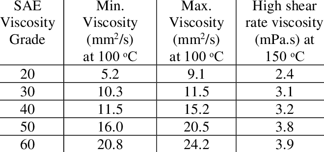

Like information? Early SAE grade chart:
In between chart:
More current chart:
Look at the HTHS values. The value your rings and lifters see. Focus on light 40, the 30 and 20. What pops out at you?
In between chart:
More current chart:
