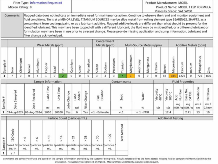

2 hours ago, VicFirth said:
Mobil 1 ESP 5w30 SP
 19 BMW 440i
5,000 miles on the oil
2019 BMW 440i (B58), M1 ESP 5w-30 5000 OCI, 50k mi
VOA base on this chemistry is just over 6 units. The result is under half and no attending TAN. That would make it change time at these miles in my OPINION. What I would call,  "Using UOA's to FIND your mark". You don't like mine, pick another. It's just an opinion.
