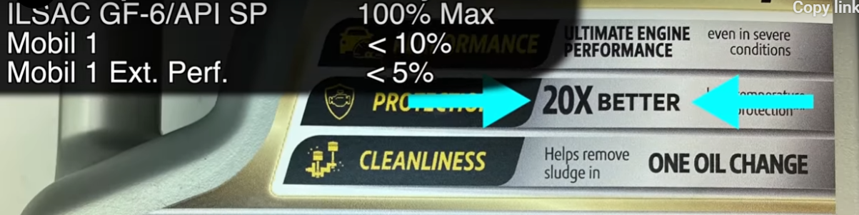

29 minutes ago, VicFirth said:
Notice how oxidation resistant Mobil 1 is.  (5:40)
Don't give up there. Continue past 6 minutes. Note ring grooves and third land then go back to the comparator charts for reference. Now go back to the first video where he talks about the cause of ring deposits and see how that fits with this video.
Remember, he is a sponsored channel. Remember as well the claim is against the lowest benchmarks in there are. API/ILSAC. Not that they are a cinch to pass, just the lowest standard.
Remember as well that oil has to perform well in ALL phases, not just the one being showboated.
Lastly remember that most of these tests are on new oil and that matters for many, but not all things.
So what’s the common denominator for making deposits in the first two tests?
Same variable ( that has a tremendous affectation ) in the Toyota dyno test?
FUEL
What leverages the fuel impact in Toyota dyno test. Multiport and DI injectors. Not just DI like most cars.
Fuel burn, delivery, EGR, and PCV have more effect on engines today than engine oil!!
