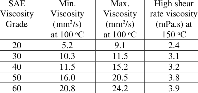

Here's the problem Stan. The oils you and I grew up with.....they are few and far between anymore.
What you and I and most our age grew up with:
More recently:
Motor Oil Basics: Oil Viscosity Grades Select Synthetics, 53% OFF
Dexos1Gen2 and 3 have a 0W20 HTHS of the minimum 2.6 cP Group III/IV
Red Line HP 0W20 is a 2.9 cP fluid. (SAE 30 spec) POA/POE

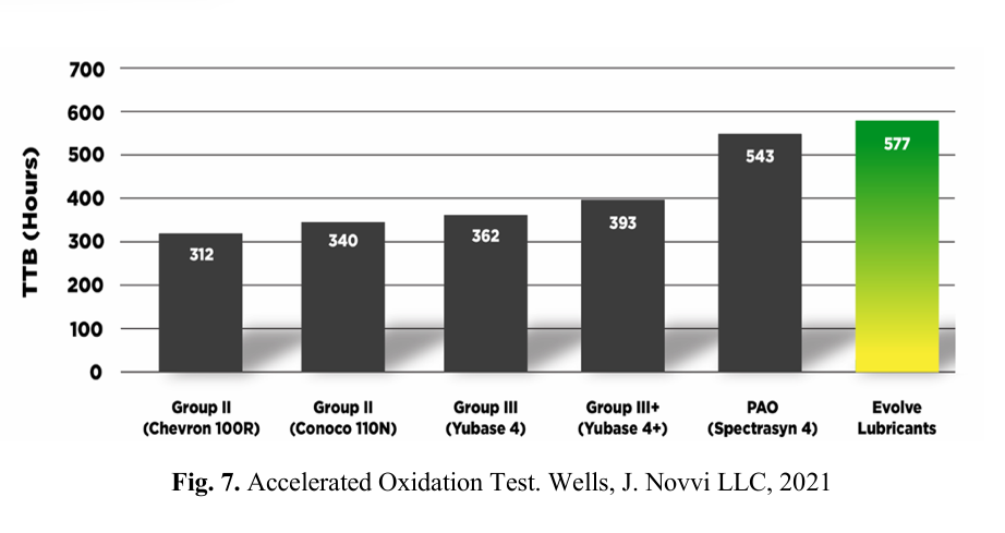

Evolve EvoSyn 0W20 is at 2.91, also SAE 30 84% plant based.
Every Choice Matters
You not believing that doesn't.
The shear stability of the Evolve oils really stand out.
0W-20 is 2.91:
5W-20 is 3.36:
5W-30 is 4.09:
5W-40 is 3.97:
Their Racing 10W-40 is 6.17:

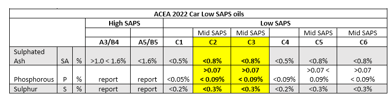

Is having too much detergency bad in an oil?  Oils like Red Line and HPL have very high sulfated ash levels.  I imagine HPL is well above 1.4.
In my experience YES.  They will leave needless deposits on spark plugs in a perfect engine and in a blow-by baby they can foul valves , EGR system, after treatment, and 02 sensors etc.
Why there are chemical box limits on additives especially organometallics.
Depends on the motor's health. Depends on the oil's health. Both change over time. Ash can leave deposits under certain conditions. But the concern in the 'Industry' is how these affect the aftertreatment, not the motor itself. To get to the after treated areas the motor must pass that oil to them. Read that, use oil and it must do it in enough volume to 'poison' the cats, after filters, O2 sensors. GM considers a quart in 2K miles "normal'. Some Euro machines consider a quart in 1K normal. Common, yes, normal it isn't.
GM Dexos1Gen3 standards are SA equal to or less than 0.9%, Phos 0.08% and Sulphur 0.45% Gen2 was 1% SA.
Porsche A30 is even tighter.
Using that much oil and using OEM recommended oil of these values still have to beat the distance for the Federally Mandated Emissions warranty.
So, how much oil does the motor use is relevant to your query.
Second consideration is the oils health. Your oil of choice in YOUR motor, operating under YOUR conditions; does that oil 'fail' some other fatal limit before the TBN reaches 50 to 65% depletion? Does it stay in grade and if so HOW. Does it stay clean that long? Few labs do a pore block particle count because it is rarely an issue under OEM length OCI's. But a guy trying to wring every mile from the oil based on big chemistry may.
As you can see the exact answer to your question depends on you and your equipment. As Dyson used to say, "Hand in Glove".
