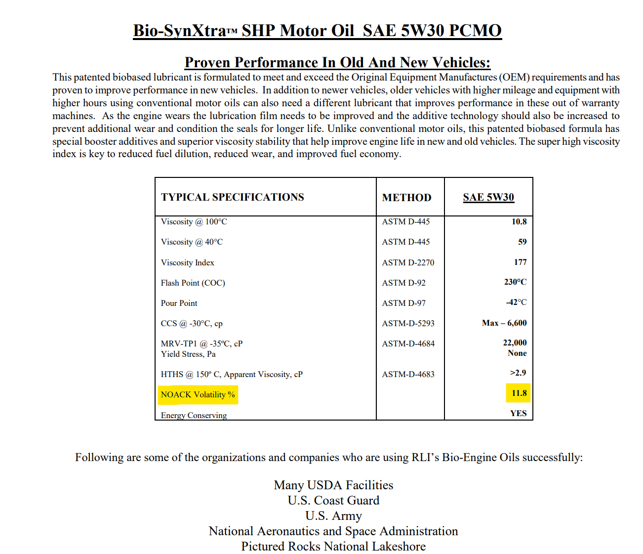

BioSyn is interesting.  I did notice the Noack is quite high though.
Correct. Doesn't necessarily translate to higher oil consumption in these formulations.
For instance the new formulation of 5w-40 HD low ash carries a 4% NOACK.

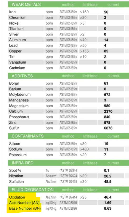

This caught my attention.  HPL Supercar 0w20 in a HEMI.  About 12k miles.  Wear metals were fine.
Virgin oxidation for this oil is stated to be 23 according to what I have seen.  It's now 46.  So it went up 23.  However the AN is very low and BN high.

There’s nothing good about this report. Too much wear. Poor combustion dynamic. AN & BN mean nothing if wear is sacrificed.

I agree with Customboss, nitration is way too high and wear metals are as well.
To me this is prof longer OCIS are bad, the answer is better oil or shorter OCIS. Repeat I know.

12000 miles on oil drain? 12,000 on engine? Which Hemi? All that background matters.

12k on oil.  50k on 5.7L engine.
