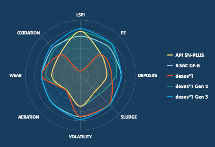

This is getting ridiculous.
20% lower treat rate improved wear control? Not by their own presentation it didn't.
What it said in print isn't what it graphed. More marketing nonsense. Great explanation of how GM, a huge market share driver for Infinium, is driving the bus based on FE (fuel emissions) "CREDITS" issued based on "GOVERNMENT" which is driving small high-pressure motors requiring LSPI protection to limit warranty losses. Wear control is NOT part of the equation. It is part of a LIE.
