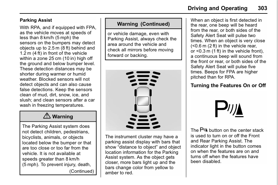

Can yo not turn it off per the Owners Manual" says? Here's a video for use location & a copy o Owners Manual or some possible help

Can you not turn it off per the Owners Manual" says?
It is possible but doesn't it turn back on again everytime time truck is started again?
To be honest, I don't know as I've never tried it.
Did u watch the video showing the fuses to pull? Not sure if they affect other stuff.
