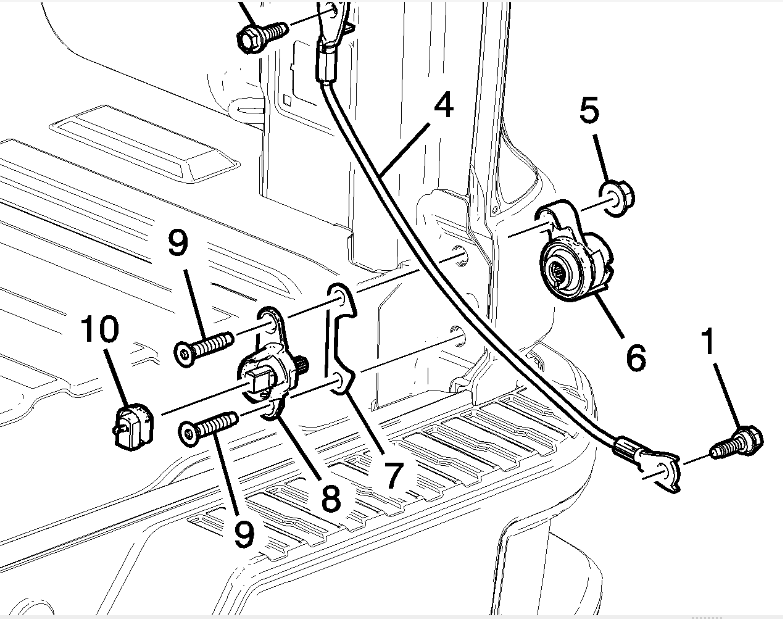

The bushing takes up the space between the hinge cups on the right hand hinge and is what keys the right side of the gate to the right hinge.  The right hinge is then splined into the damper behind the right tail light.
If you have the push button power release tailgate, you'd have the EZ down (damper) and the EZ up function (torsion bar).
If #10 is the bushing, it looks similar to the K2XX part (#84331136)
