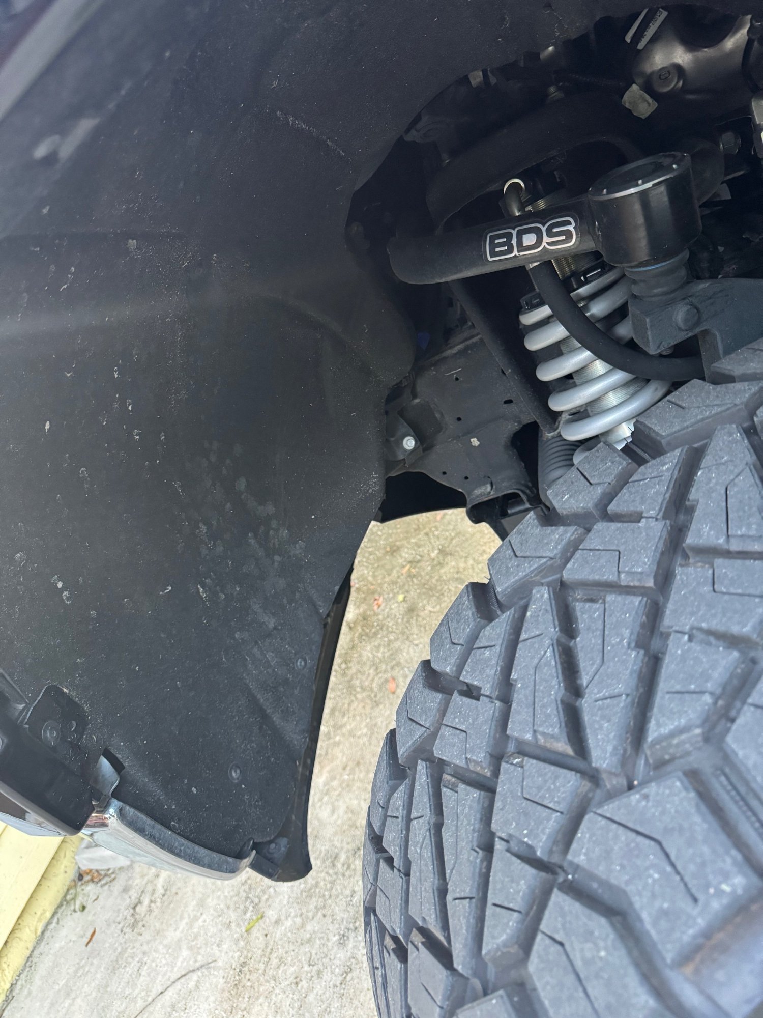

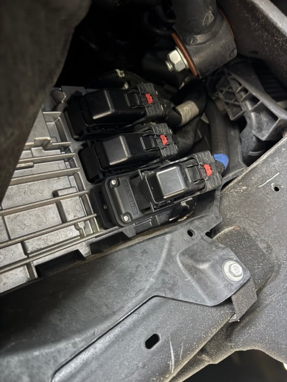

Ok that was a piece of cake!
I’m on a 6” lift and I didn’t even need to pull the liner. You can pull it back enough to access the ECM. I bet you could do it on non lifted truck too. Just crank the wheel to left and slide in there.
Took me 5 minutes; which means swapping it for recalls etc won’t be hard.
its right above that silver bolt by liner there.
