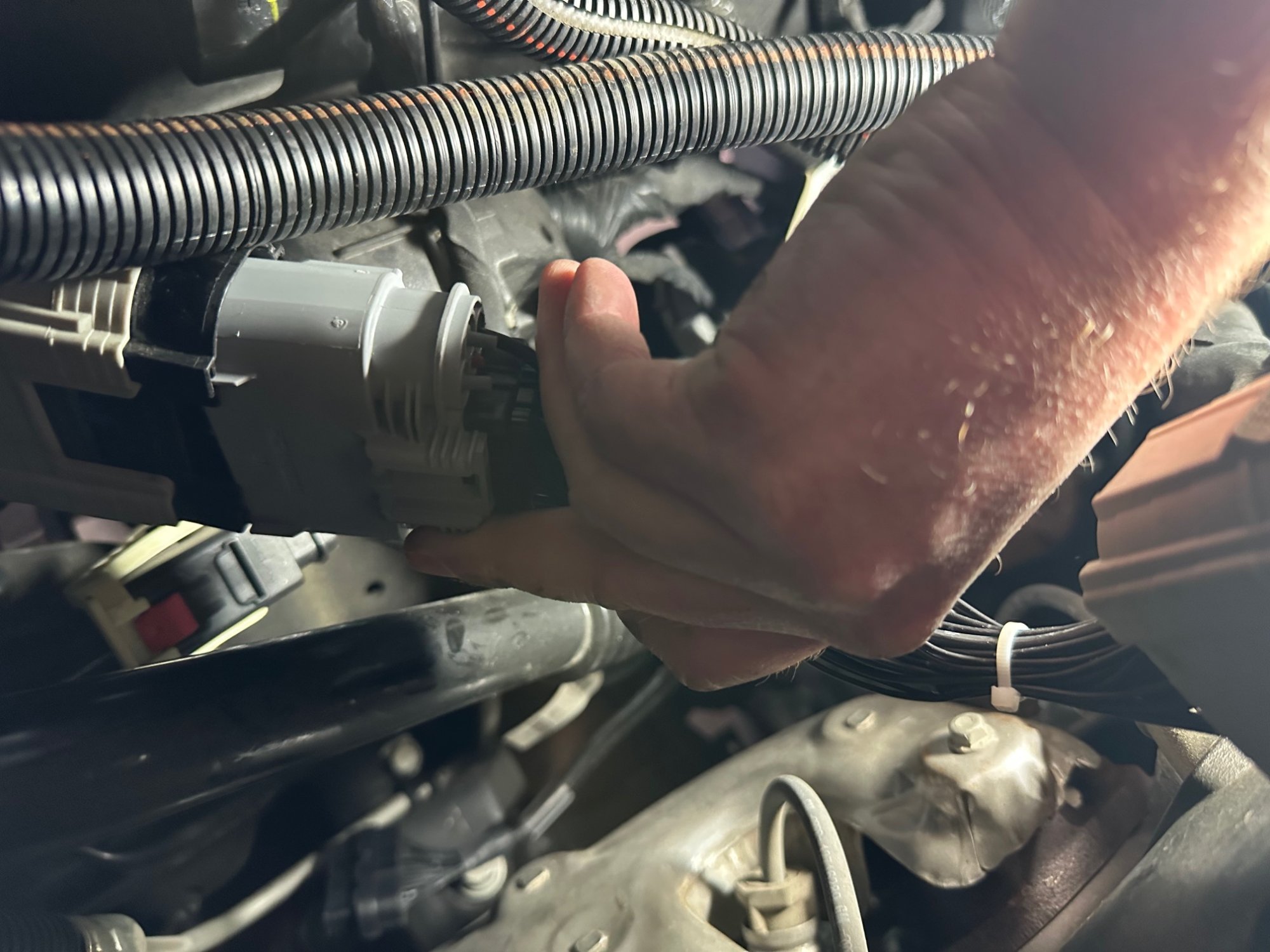

finally got around to installing this.  Went to plug in the harness and it doesn't fit the oem plugs of my truck.  The 2 guide rails on the connectors of the Pulsar plugs are further apart than the ones on my oem plugs.  I reached out to Pulsar and they are telling me it should fit; well it doesn't.  Ugh, hoping they will take it back, but no further response from them yet.  the raised part of the grey connector, as seen in picture; top one is lined up in groove, but bottom one doesn't line up as it's spaced further out.  oem plugs spacing is 2-5/8" between the 2 guides and the Pulsar plugs are 2-7/8" apart.  Guess they use slightly different Delphi plugs.
There is another connector that is very similar looking in the same area..try it. I ran into the same issue. Instructions are horrible at showing the correct one to plug into. If you havnt figured it out by tomorrow, i'll get a pic of where mine is plugged in.
I gave up for the night.  I didn’t see another connector like that in that area anywhere.  If you don’t mind sending a picture my way that would be great.  The one I tried is right below the coolant tank and brake fluid reservoir.  It has a big plastic bracket coming off the frame rail up, and the comnector has a christmas tree clip holding it to the bracket.  Wire harness runs from firewall, along inner fender up to the ecm.

I finally got mine installed recently after talking to TS423.  I was overlooking the correct plug like a big dumbie.  I’ve only driven the truck once since installing it and the throttle response is noticeably better in setting 3.  When going through all the different programmable options I noticed the rear gear ratio defaulted to 3:23 so I changed it to 3:73, along with my tire size from 34 to 35’s.
