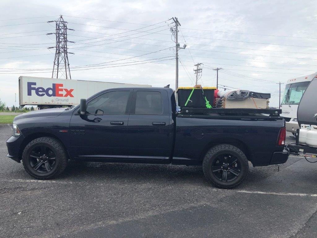

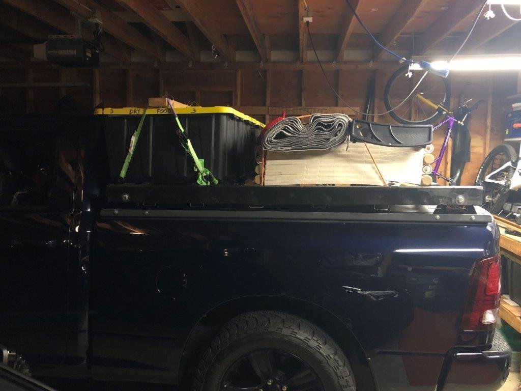

I tow a 35' white box between 6500 and 7800lbs depending on the year, we rent from a place that gets new rentals every 3yrs....
"legally" if you get pulled over axle ratings and the corresponding weight slip from a cat scale is the bottom line. it's a little different if you're the cause of an accident but arguably you could also use axle ratings for that.

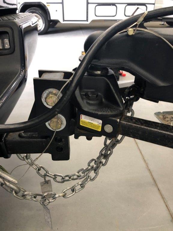

you're gross axle rating is 7,600 lbs with the front axle rating at 3,800lbs leaving 3,800 on the rear.  I use an equalizer hitch, the good heavy duty one typically from the rental place and it's tough because all my weight is in the truck.... i pickup the camper en-route and i don't want to unload my truck.
it's do-able but takes some time at the scales.
I upgraded my brakes to ebc slotted rotors and the hd orange pads.
i finally got a GDE tune for my ecodiesel, strongly recommend it for the babymax also.
anyways, axle rating is what i go by, it's what truckers use.

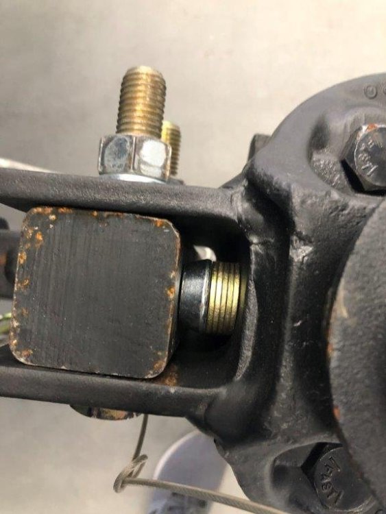

every time we go i have to adjust the L brackets because they just aren't doing enough at the scales, but i bring hefty tool box with all the stuff.  these brackets ended up 1 hole up after scaling it.  have to jack it all the way up on a 12" telephone pole block to get the bars preloaded enough.  Unfortunately the cooler and the generator go behind the rear axle.... i try to leave an alley way to roll them forward of the axle but it never pans out.  that is not ideal as you know.  usually i'll move the cooler into the camper... not owning the trailer, you can imagine everything going in the trailer is in my truck less the wife and dogs who drive separate the next day.
