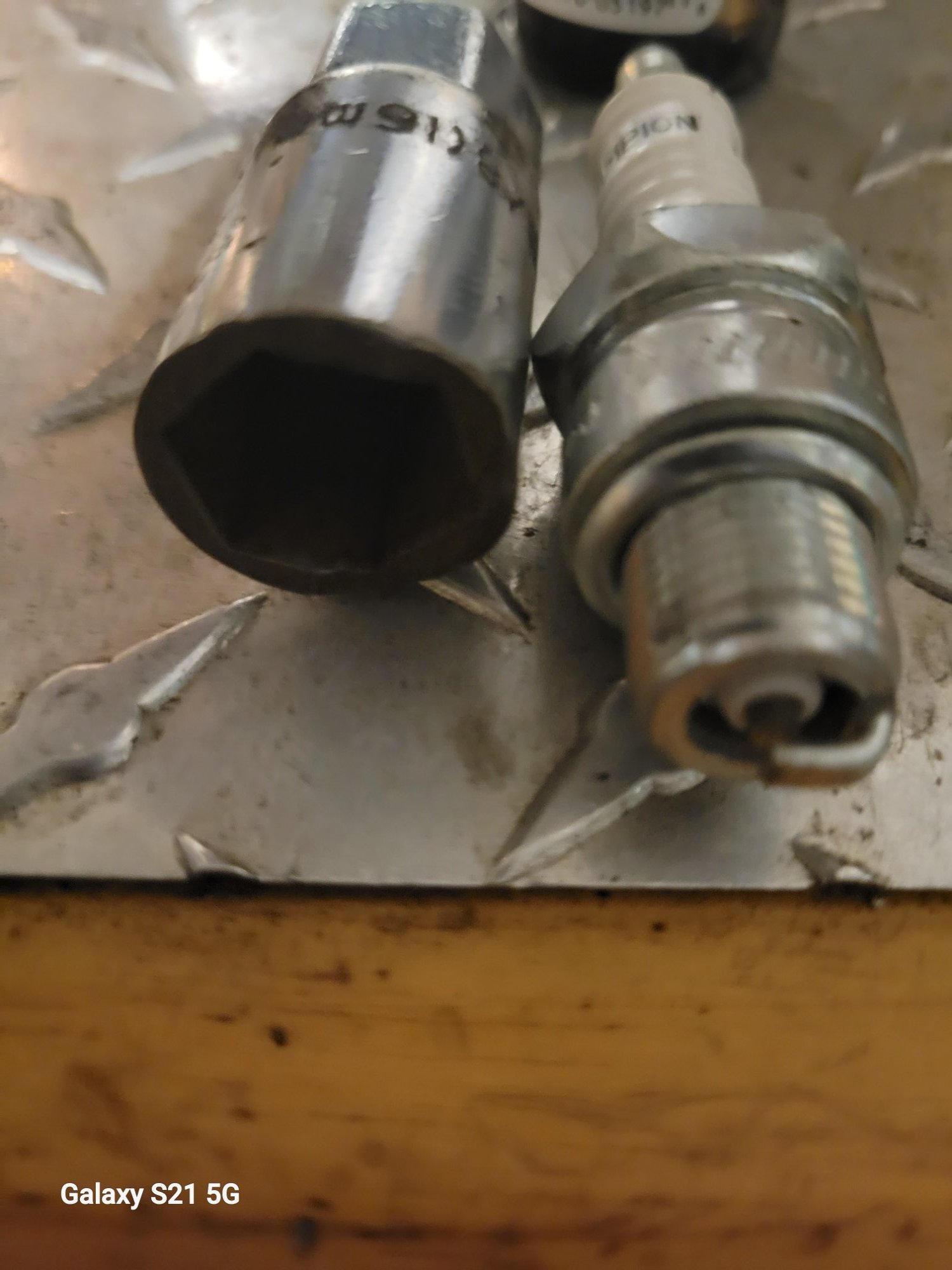

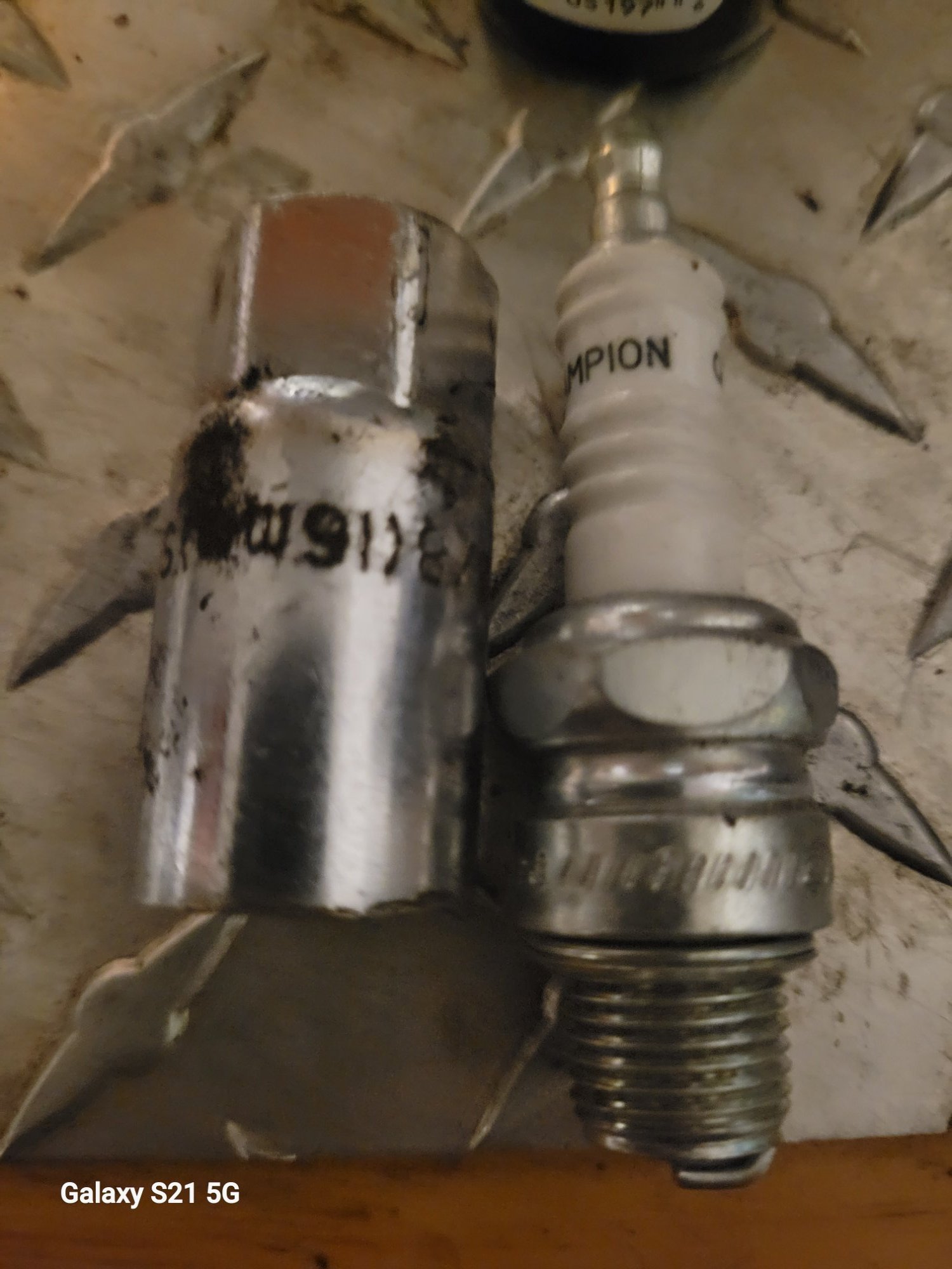

Here's a little trick.
Cut a socket like this down and remove the rubber inside. This is a tremendous aid in getting them in by hand, especially toward the firewall.
