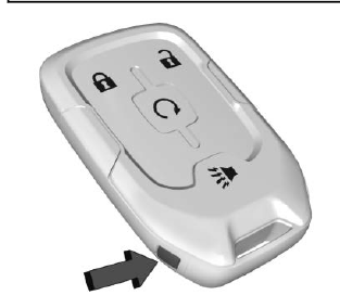

There is a key in the fob that will unlock the door.

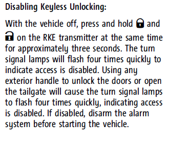

Maybe the keyless has been disabled (but since it won't start this likely isn't the issue)
If so, they can be re-enabled

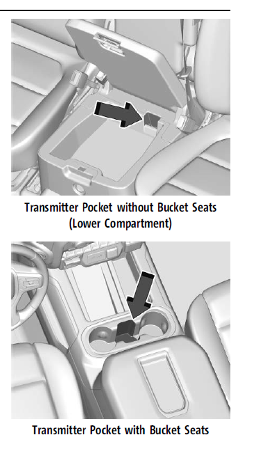

There is a spot to put the fob so the vehicle can be started even if the fob has a dead battery.
Uses a different way of getting a signal from the fob, so it might make it so you don't need to use the phone app to start the truck.
