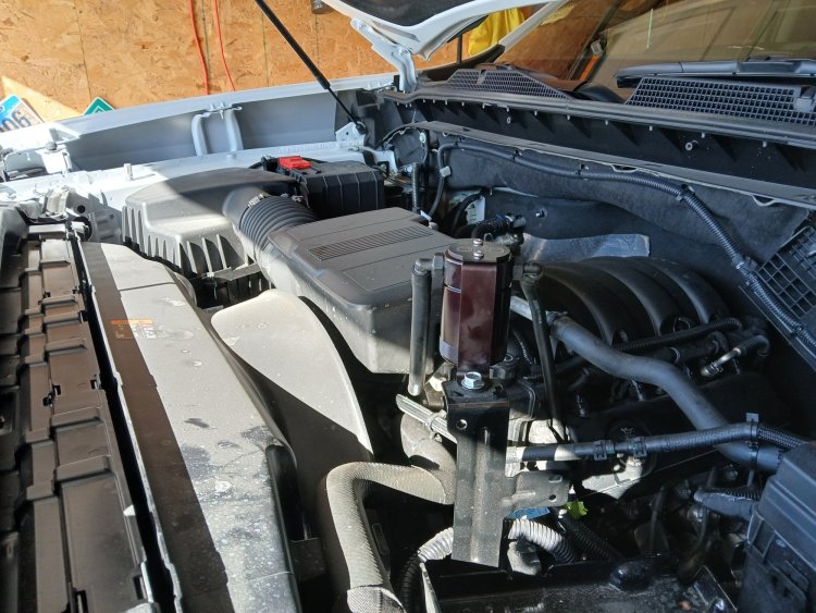

This is what I put on my 2022 HD.  I have the black anodized one.  I mounted mine in the auxiliary battery tray. Inverted the included attachment bracket so the can sits a little higher, making it easier to reach.  Up here in Northern Maine in the winter, I empty it every other week.  Summer months, it does not accumulate much.

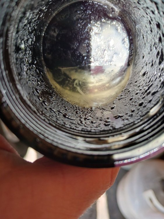

The first pic is winter in upper MN 44 mile drive, fresh oil change, can was empty and wiped clean, it took out that much water. So really good for winter use, dont catch as much water vaper in the summer.
Again, is it needed,,, no, does it do something, yes, its not that expensive and easy to install or remove.

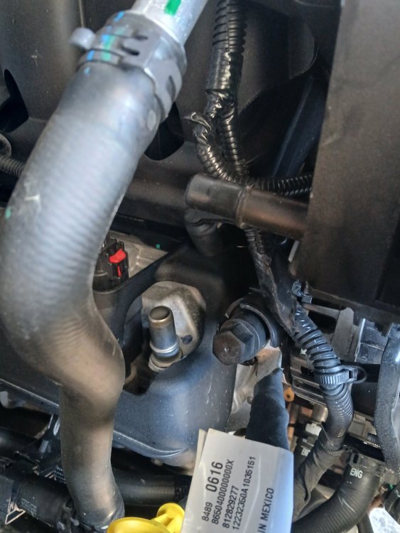

The next pics are of the intake to valve cover tube wiped inside tube and connecting points with the Q-tips, notice clean going from the valve cover to intake.
Looks like condensation...as expected. That burns off with no issue and actually is a good thing. I will not install.

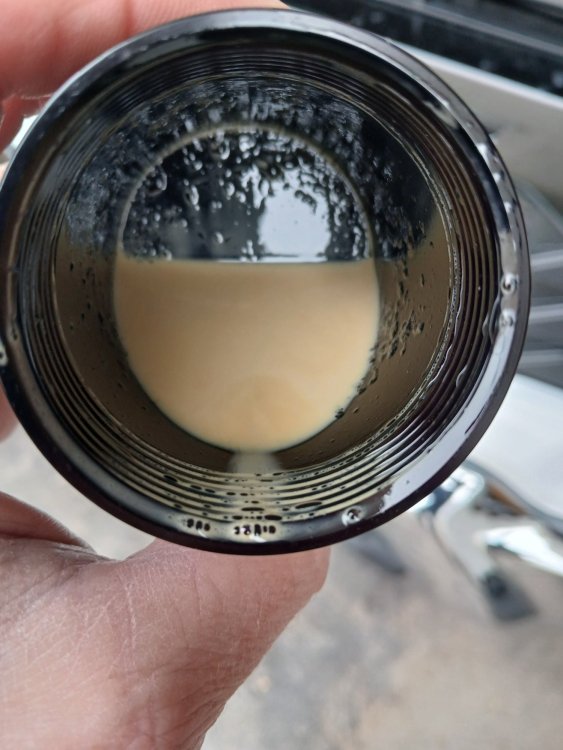

This is a pic of about 4500 miles, i used a small milk jug when in the mood to check and empty the can, the other pic is a 10oz cup i pored it into.
            Oil on top, water oil fuel burnt and not burnt middle and sludge on the bottom.

That looks like a 1 quart jug. So maybe around 4-5 oz of fluid?
As i did an oil check and catch can check yesterday. I hadnt check either since my last travel day north towing the 5ver. So 8 days. The can was almost full of the normal oily tan water mix. Fullest i have seen it so far. I should have take  a pic but i was so surprised, i just dumped it and put it back on.
So the best time for it/the can to do something seems to be colder weather as it sucks out moisture. Colder being very, very upper Minnesota weather. Summer very little moisture but oil vapor from pcv valve adds up at the bottom of the can.
      The moisture burns off at some point anyway, without a can, but dumping a good cup of water stuff before it burns off cant be a bad thing.
