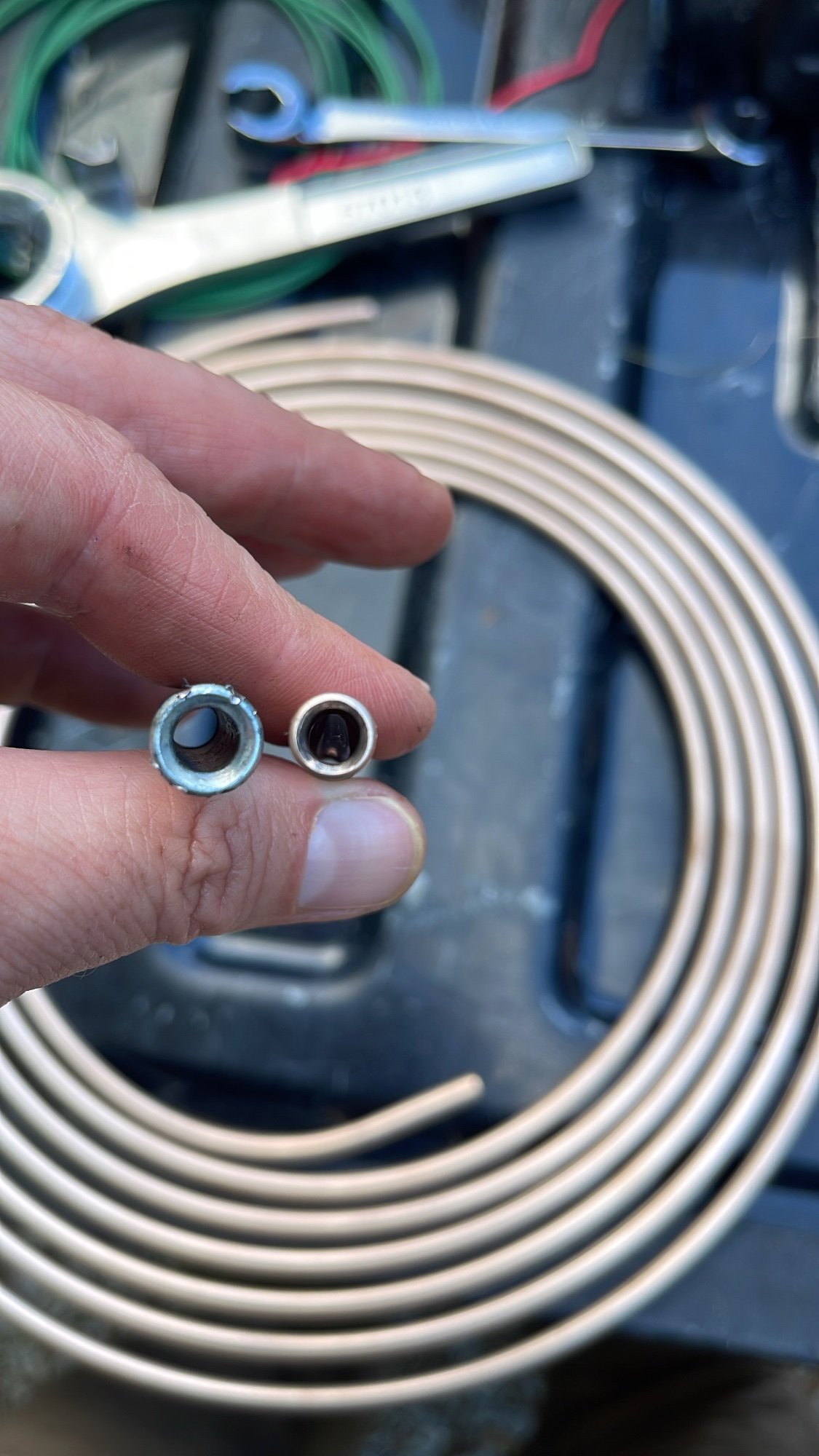

I’m trying to replace my brake lines on my 2013 1500 rust bucket that run from the master cylinder to the abs module. It’s 1/4” line but gm has 1/4” inside diameter while the nicopp line has 1/4” outside diameter. Plus gm had the steel line (thicker) and the protective (not much protection as mine rotted out) coating on the outside. Anyways, the nicopp line is too small for the factory gm fittings that worked with the thicker steel line. Does anyone happen to know what size the fittings are for the abs module and for the master cylinder?

I think you have the wrong size line, probably 3/16, I have never had an issue changing to Ni/Cu, done many many. Even the plastic coated line is standard size, Possibly it is metric line you are trying to replace, I don't believe metric line is available  in Ni/Cu

The specific brake line I’m trying to replace is listed as 1/4” line. The part number for those lines is just a 1/4” inside diameter x 16’ roll of steel pipe. I might just have to bite the bullet and order the steel pipe from gm and bend it as best I can.

Just went back to this in the catalog.  Two different size lines from the master.  The line closest to the firewall shows as 1/4", the line farthest shows 5/16".

Interesting. I’ll have to measure the diameter on mine. They look identical minus a few bends. I was actually able to potentially find a pre bent kit through sstubes.com. Hopefully those will be an exact fit so I can stop throwing money at fittings and different sized pipe and various tools.

My gauge shows both lines coming out of the master cylinder as identical inner diameter and outer diameter
The GMT900s have 5/16 brake line running from the MC to the EBCM. Take your fittings to any parts store and they should be able to match them up as they're a common fitting size.

I found a company sstubes.com that sells a front brake kit  that includes the two master cylinder to abs module that they say will fit my truck. Not sure why other kits wouldn’t that I searched and called. Perhaps because their kits were complete kits and the rear lines are different? Not sure. There is a delay on their stock so I won’t receive the lines for a few weeks. They come pre bent and flared and with proper fittings. I was also at the parts store today and I saw a correct fitting with a 5/16ths bore so maybe I could have used 5/16ths nicopp with that fitting. I’ll try and update once I get the lines routed in place and determine if they work or not.
Good luck with stainless lines, they are hard to bend. The lines are installed on the chassis BEFORE the body so trying to install prebent lines can be very frustrating, sometimes requiring unbending, cutting and splicing

Thanks. These don’t look too bad with the front wheel well liner removed. I’ll have to go slow and steady of course.

The part number lists 1/4” brake pipe. With the inner diameter being 1/4”. So maybe the confusion is the inner diameter vs outer diameter? If these pre bent lines I ordered don’t work then I’m going to go back to nicopp and get 5/16th line.
