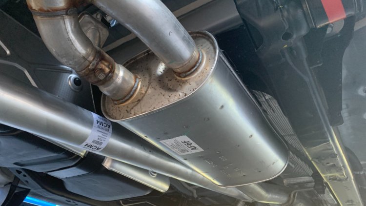

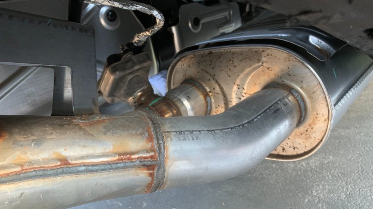

Its a single in offset with dual outlet that y's back to single again, then that y's back again to the dual tips, the factory setup with the dual mode exhaust.
The problem I see with even switching out for a new single in/dual out is all modes will be louder.  The stock muffler is set up like the Corvette and Camaro stuff where inside the muffler body you've got one outlet handling the "loud" and the other handling the "quiet" with its tube set up to muffle sound.  99% of the aftermarket mufflers out there won't have this design.
I'd look into GM's option on this perhaps?  GM sells a recalibration to make the stock stuff louder.  35% louder on startup in sport mode and 10% louder cruising:
Chevrolet ZR2/AT4X Spec Active Exhaust Calibration | 85822149 | Chevrolet Accessories
The only company I see that makes a full cat back that retains the stock valve function is Flowmaster.  They just launched 3 kits for it.  Theirs will flow the muffler in normal drive mode and in sport bypasses some flow to an under cab dump pipe.  Flowmaster Launches Active Valve Exhaust Kits for 6.2L Chevy Silverado and GMC Sierra - Holley Motor Life
Everyone else's setups require a valve bypass simulator to be installed.
IMO, The $395 calibration sounds like a bargain here.  More sound, retains the valve function, plus like their other NPP stuff, they did a great job on the sound IMO.
