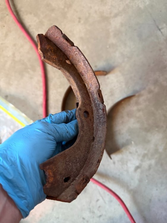

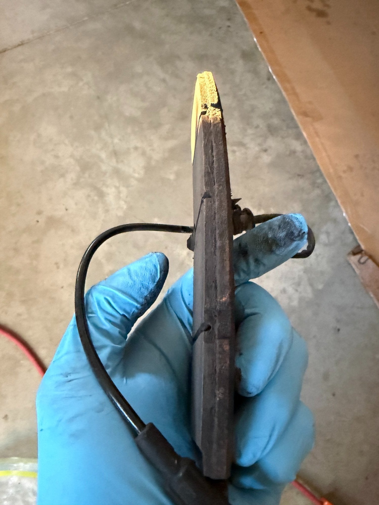

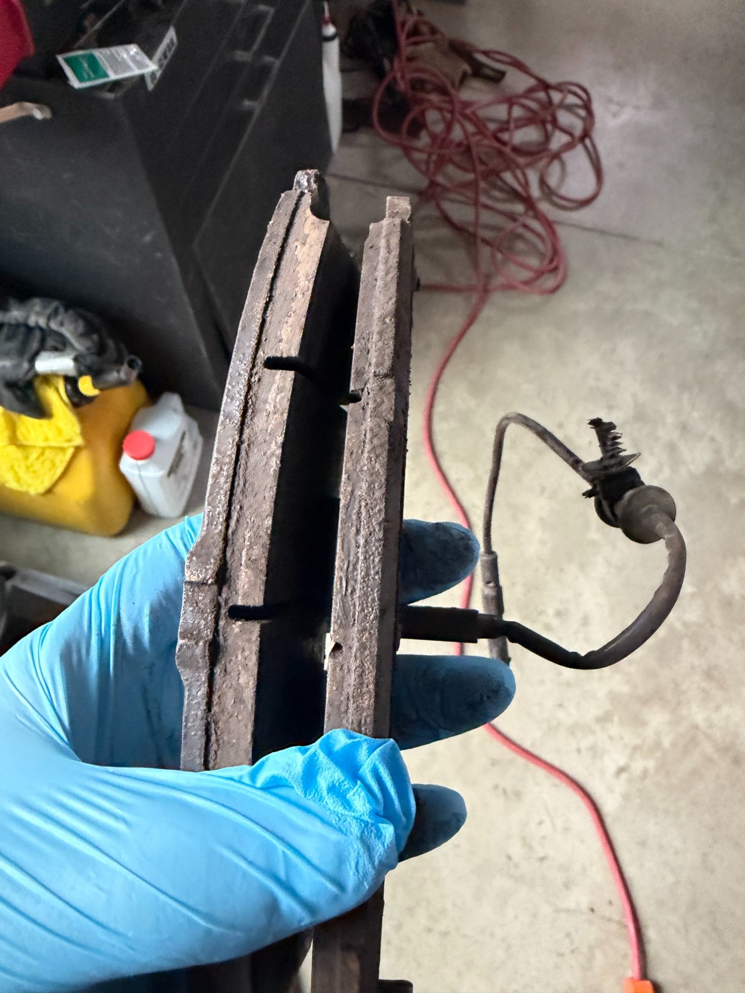

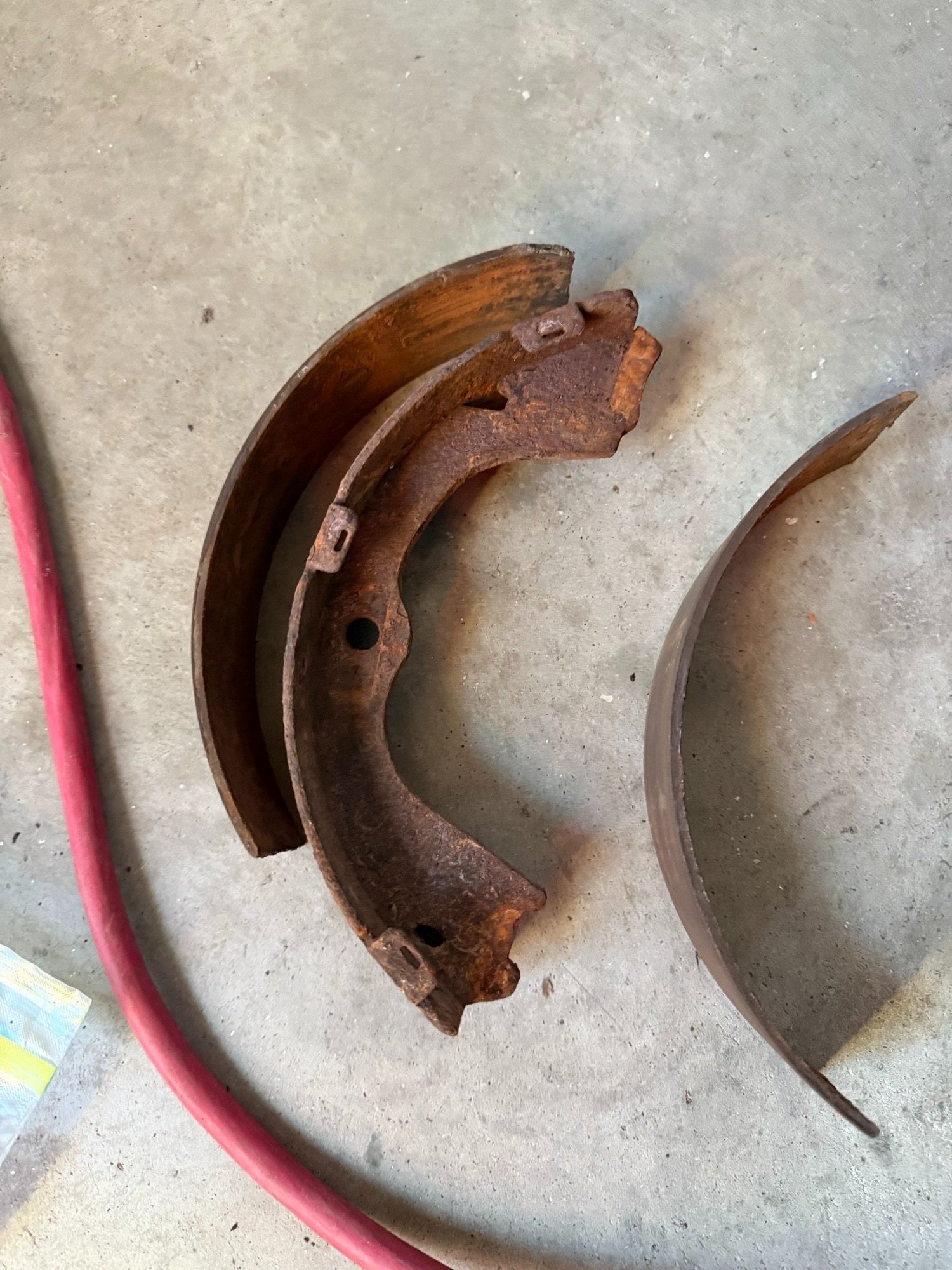

2024 Sierra 2500HD with 22k miles. I was checking my brake life monitor and saw the rear life was 30%, yet the front was 80%. Pulled my rear tires and sure enough, less than 1/8th inch of pad left on the outside pads, both sides. Of course, not covered under warranty....at 22k miles 😡 Parking brake shoes were rusted off the backing plate. I have never seen factory rear pads only last 22k. On my last 2500 both front and rear lasted 80k+ miles.

That is a horrible mess and I don't like the sounds of that because of being an HD owner and that same part brake setup. I am speculating that whenever that salt water from a winter road did get onto the parking brake, being in a heated garage I presume and what few times you did use it during the winter, the water getting behind the pad bonding rust jacked the friction material right off of the backing shoe assemblies. And the worn pads, what do the inside pads of both sides look like as are they much much thicker ?. By any chance was this truck driven from one dealership to another during the winter as a new dealer trade or a demo truck, something that took place before you even bought the truck.

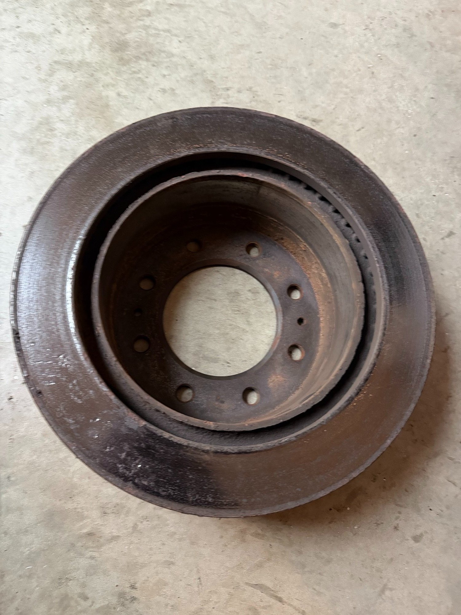

Inside pads were much thicker. About what I would expect at 22k. Rotors weren't too rusty on the outside, but parking brake side was. I had to hammer one side off because the brake material had come off and was binding up.

Its a bit hard to tell from the photos but does look like the rotor pad surfaces were rusting but then the pads grinding that off but the rust is deep enough that the pitting is left behind and I can see the imprint of the pad on the outer side of the rotor and that always shows up when there is rust happening each time the vehicle gets parked and see that ghosting of the imprint. But like you say the vehicle isn't set up differently then your prior truck and used similarly. Even though you drive it only when the road surface is dry, there is a very good chance that the salt dust is being kicked up and enough of it getting on the components. I wonder if the caliper system is slightly different and even though it seemed free floating, that it reacts a little different then the calipers on the prior truck on the side that was worn. Oh and the other thing, are you using adaptive cruise on this truck where perhaps you never had that on your other truck ?.

It seemed odd that both outside pads were normal and both inside pads were thin. Makes me think a caliper issue, but both sides?

The parking brake shoes were just like any other parking brake. I just used a brake spoon to turn the adjuster back in all the way. No special procedure to change the shoes. There are three springs, two on the top and one on the bottom by the adjuster. The one on the top in the back, is a pain to get on/off. There was no special reset needed on the dash.
Pads and rotors were a breeze. The caliper bolts are some crazy torque, needed a breaker bar to get them loose. Other than that, nothing special. After I changed the pads/rotors, I started the truck and pumped up the brakes. The truck recognized it had new rear pads and reset the monitor. There is only one "pad sensor", it is on the driver's side. It clips into the pad (you can see it in my first pic). You have to get a new sensor each time you change the pads. It wears down with the pad. Hope that helps.

Sorry I misunderstood which side was worn down more, so its the inside pads that were the most worn and like you mentioned that is the side the sensor is on. I never had looked that up or thought to actually look at my truck and realize there is only one sensor per axle then I assume, but makes sense now that I think about it "front/rear" on the dash and definitely its only a slight guide for what actually is going on at all four corners of the vehicle brake issue wise.
Over the years in working on brakes on vehicles ( all much older than what your working on ), more often then not one pad would wear more than the other and some pads are made to have less sweeping area of pad on one side of the caliper vs the other although it doesn't appear those are designed that way. So then its the back side of the rotor that I assume its hammer hits on to knock it loose where the more worn pads were riding on and it has a more ground in worn surface without what I called that pad ghosting, another words more metal worn away vs the outside rotor surface. This also demonstrates that issue around rotors on axles back from the steering axle that get all the crap flying at them from the front tires, they have a rough life unless its dry clean pavement the vehicle is always on.
I've had it happen a few times with the same truck that on the front axle as it has rear brake drums, that the outer diameter face area of the "inside face" of the rotors would rust in so deeply into the material that chunks of the rotor were falling off of that side. The pad was not reaching right to the very outside edge diameter as brake pads rarely do and the salt and calcium would eat into that area of the rotor and then almost rust jack pieces of rotor fall off and once that happened a portion of the pad would be riding in the air as there was no rotor surface under it. Its all because of the crap spread on the roads, any farm trucks that never get used on the winter road have no issues like that at all and years ago before any salt was used ( before my time as an adult ), people had their rotors turned. Not any more as they are junk due to lack of extra material and the corrosion factor. But on that vehicle and with reman calipers etc a few times over it never failed that the inside pads always wore down sooner that the outside, for one thing more road crap was able to attack that inside face of the rotor.
