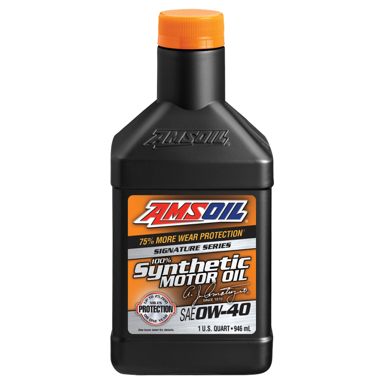

15 hours ago, Black02Silverado said:
Just wanted to post this incase anyone is interested in AMSOIL's Signature Series 0w-40 for their 6.2. It meets/exceeds dexos R. Let me know, I offer a special for all GM-Trucks members.
https://www.amsoil.com/p/amsoil-signature-series-0w-40-100-synthetic-motor-oil-azf/?zo=521390

AMSOIL Euro 0W40 does not carry the Dexos R recommendation nor the SN+/SP designation. (LSPI)
AMSOIL SS 0W40 carries both.
SAPS levels that kill cats and O2's is more a function of how much oil the motor is consuming, not the level of ash. It took nearly 200K miles of Dizzy's 300K using oil at a clip of more than a quart in 1500 miles using a Full SAPS oil to set a P420 code.
There is still no definitive test for correlation of SAPS to Cat life, although most CLE's will agree that levels like those in break in oils and motorsport oils will be harmful if used for more than than beak in miles on cat equipped vehicles, that is levels over 2000 ppm.

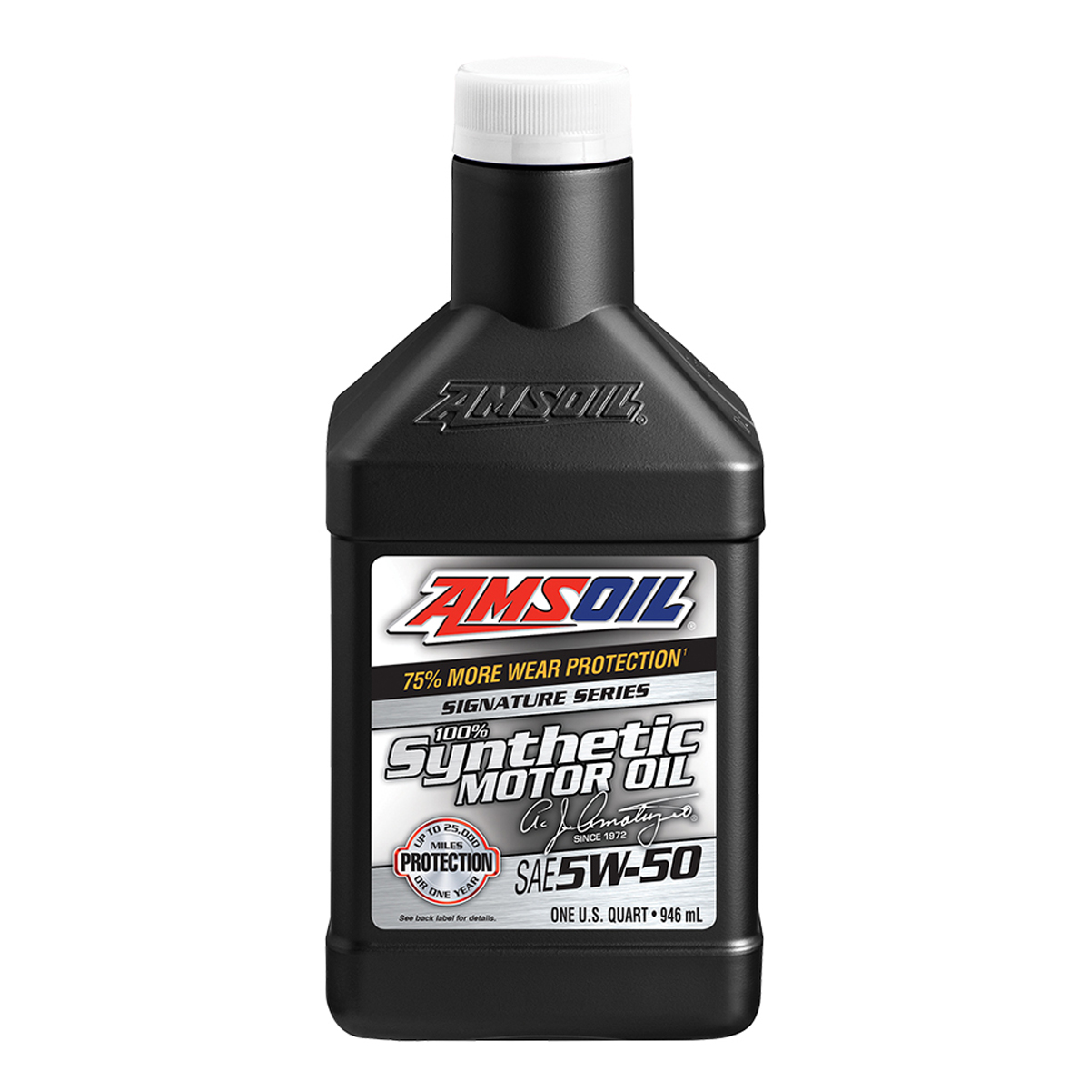

I would have made the move anyway IF the SS product line were still offered in a 5W40.
The SS 5w50 more or less occupies the range of RL 5w40. HTHS is right there.

AMSOIL has that covered as well.
https://www.amsoil.com/p/amsoil-dominator-15w-50-100-synthetic-racing-oil-rd50/?zo=521390
But to meet dexos R then 5w-50 is a better option since it is made for street use. The racing is more for just track and I guess works since you are supposed to dump it once done playing on the twisty's.
https://www.amsoil.com/p/amsoil-signature-series-5w-50-100-synthetic-motor-oil-amr/?zo=521390

I'm not understanding how what Mobil is doing in disqualifying AMSOIL SS AZF 0W40. Edify me. Please.
Edited by Grumpy Bear
The 0w40 Supercar is low SAPS (same as ESP Formula just new name) and not API SP.
Amsoil SS is API SP but I don't see a SAPS published.
Therefore, SS in 0w40 would be the incorrect oil per Dexos R 0w40.  Dexos R 0w40 = ESP Forumla 0w40 = Dexos 2.
The SS 5w50 for the Z06 and ZR1 is fine because Supercar 5w50 is an API SP oil.
I love Amsoil as much as the next guy, but I'm not seeing how SS is the right choice here given the outlines of Dexos2/DexosR.  Going off the Dexos2/DexosR path, Amsoil FS European is the correct choice.
Edited by newdude
There is more to the dexos R specification than just what is talked about here. Many more parameters that it has to pass than just what is listed.  Information that isn't public knowledge. AMSOIL isn't going to show the full formulary due to proprietary properties. But be sure that if they state it is dexos R, it is or GM would be taking them to court.  We all know they and other companies don't play the game of "pay to play" when it comes to being dexos rated.
AMSOIL is constantly tweaking their formula to improve it and with each tweak they would have to pay to be on the GM dexos list. That money is put toward improvement of their products as well as keeping the cost of the product as low as possible.
Edited by Black02Silverado
  • Like 3
You do see the lack of congruent conclusion there, right? The additive difference between those two SS oils is the Vm's polymer molecular weight. The only difference. SS 0W40 V SS 5W50
What? FS is full SAPS! 1.0+ ash. Kind of the definition of FULL SAPS.
SAPS is more than ZDDP, it is every additive with a Sulphur backbone. ZDDP, Ca, Mg, Moly and inherent S. Converter life is a phosphorus issue, not a ash issue. LSPI is a Ca issue not an ash issue. Actually it's a combustion end gas issue and Honda has know that for about forever. SAE tech paper on that dating about 1965.
Now all that said, people will protect a warranty before they will protect a motor. I get that. But I also understand and have proved to myself in 56 years of driving and maintaining that when ring seal prevents oil consumption ash is irrelevant. (Within reason).
This OEM insistence on low ash oils isn't about high ash oil killing cats, it's about hedging a fragile ring seal that promotes fuel economy and sacrifices oil integrity. The perpetuation of the idea that a quart in a thou or two is garbage. Even low tension rings, properly broken in and properly lubricated (sealed) will take the additives loads required to maintain that seal long term.
Last note. ASH as defined in the specification is only the ash incurred by the add package and calculated. The autoclave ash is MUCH higher. It's what you get when you thermally oxidize (burn) a Hydrocarbon. It is literally a shell game.
