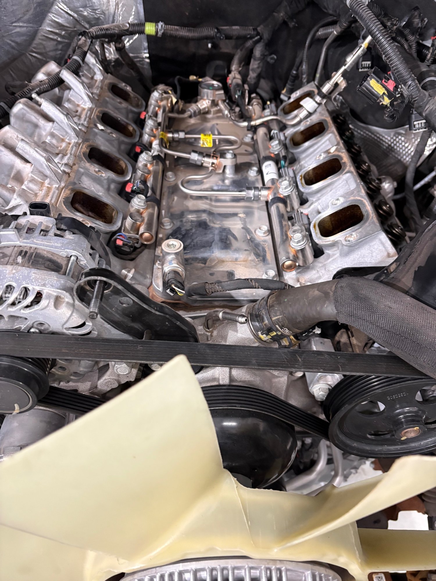

On 4/28/2026 at 2:28 PM, Chuck FB said:
Have you been doing your own oil changes and if so any particular oil filter brand you have been using. Also within that theme of oil changes was the oil changed just prior to this occurrence or a while back.
I am purely speculating that something mechanical either let go due to a defect and a chain reaction such as a valve dropped after a valve spring broke etc or I suppose there is a possibility that a cam or crank bearing could have turned restricting oil flow and the oil pressure would remain good on the gauge but in reality starving parts of the engine from adequate oil. I guess that remains to be seen if the dealership does a tear down or if they find a mess and determine a new engine gets dropped in and the original engine gets whisked away without a proper look.
No I don’t do my own oil changes and yes I’ve checked the oil level after each change regularly, dealer removed rollers and push rods today all look good on right bank, so going deeper tomorrow by removing head to get to lifters we will see what they find at that point!
It’s official: dealer just confirmed this evening,
I’m to receive a new long block! The number 1 rod bearing spun putting shavings in the oil.
New 6.6 engine will be ordered in the morning.

Right or wrong dealership is awaiting approval for 6.6 to be replaced caused the 28,000 mile new engine spun #1 rod bearing and filled itself with metal, oh boy! Not feeling HD DNA at this point, anybody no how this will effect the resale value at some point.
You never did share how frequently you had the oil changed in this engine? I am also curious if the air filter was ever changed or if you used an aftermarket intake?
Make sure they replace the radiator and oil cooler lines also. The oil cooler in the radiator will be full of metal and there is no approved method to clean them. GM will bounce the claim if those are not replaced when the engine gets changed.
As I believe I asked before, what the timeline was relative to the last time the engine oil was changed or any other maintenance that could have caused a foreign object to be introduced into the engine by way of the oil or the intake, including someone tampering with your truck. Also am wondering if by chance for example a small roller bearing came out of a roller lifter or one of the rockers and started a chain reaction of metal being able to get past the filter ( cold engine start filter bypassing for example ) and went through the crank bearings. I imagine it can be hard to tell after a bearing gets chewed up and sends metal around through the engine, the oil pump would have damage at that point so destroying any prior evidence. But it certainly could be a slight manufacturing mistake on the crank, the connecting rod or the rod bearing itself that eventually lead to it being spun in the con rod. I assume dealers don't spend too much time trying to sort out what could be hard to prove and if warranty covers the situation, a new engine and oil cooler system gets swapped in and life goes on.
Like others I am curious what the oil change schedule was typically like and if there were a lot of idle hours on the engine or a lot of very short runs ( potential fuel dilution ) etc at times.
I could be wrong in my thought but I rather doubt a complete/new engine replacement swap being done would affect future resale as long as the new engine is running well and perhaps some oil samples taken after its broken in to prove to you or a future buyer that its not showing any abnormal wear. The issue more so I think is when a particular vehicle platform gets a bad reputation rap like the 6.2 GM or way back with the GM gas block 5.7 diesel as buyers run the other way based purely on reputation and resale plummets as a result.
