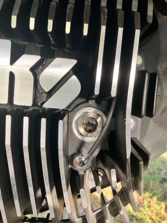

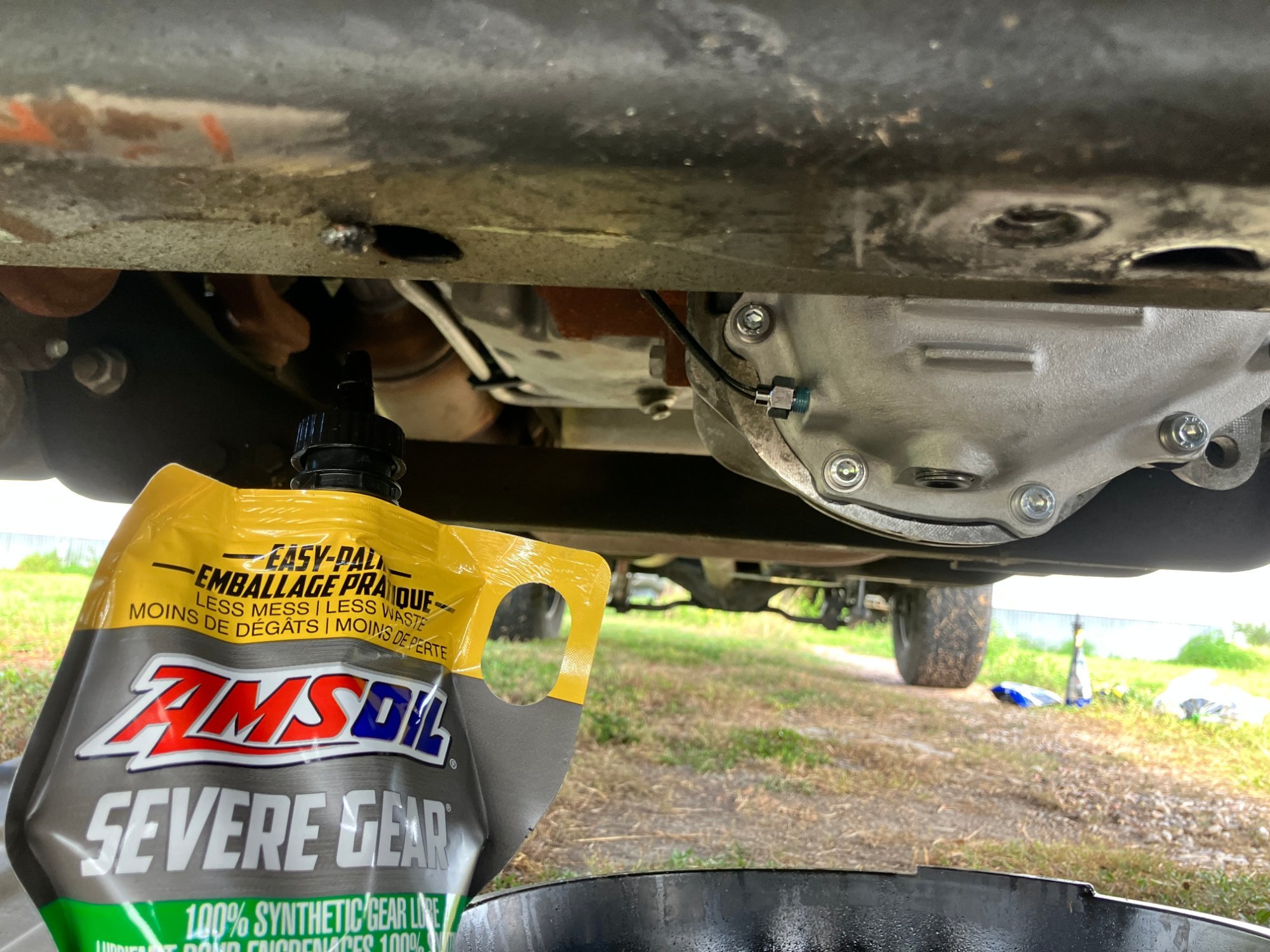

I think the Banks cover is higher capacity, given I don’t see oil in the sight glass. They say to observe factory capacity over sight glass. I used approximately 6 1/4 pints bc I assume not being able to fully drain bags, and a tiny bit of spillage when I squeezed. Got Amsoil ATF as-indicated on their website.

That is an odd comment Banks would have about the volume given that the sight glass is there for the specific reason to allow for not only bringing the level to that range but to visually be able to check at any time that the diff has a sufficient level. I know its been commented that what GM claims is the volume required for the rear diff ends up falling short of what it actually takes if filling it to the bottom of the factory level plug, and the fact that GM ( actually the axle manufacturer ) is underfilling the diff at their factory below their own specs as mine was as well which has been a whole other issue and is leaving the oil down almost a quart low from full. As I read about the Banks cover instructions right on their webpage, they do say to go by the sight glass ( half way up the sight glass on level ground ) unless the vehicle has had the pinion angle changed due to a lift etc that throws off the factory pinion angle. I'll put it this way, if I installed a Banks cover on my own stock truck I would fill it half way up the window and then recheck after the truck has been driven and sat for hours while sitting on level ground to confirm the level.

Yes I read that as well on their website and its all in how its interpreted for one thing and I believe the GM spec itself does not call for enough volume to bring the oil level up to the bottom of the factory covers fill/level port which also is puzzling. Banks are also bouncing between two different truck makes in the instructions since both the Ram and the GM use AAM axles with those instructions.
The problem with not seeing the oil in the window is that one has no idea where the actual level is. Certainly anyone else on here reading this and having worked with the banks covers should chime in as they may have more information to provide. I am just simply concerned because I don't want to see someone underfill the diff as its not just the diff that is critical to lubrication, its the wheel end bearings. The dealership I bought my truck from had two HD pickups a while back have their rear wheel bearings fail because of being too severely underfilled at the factory and no one had checked and topped them off at the dealer but luckily warranty paid for a whole new complete axle housing as it mangled the axle housing spindles when the bearings failed and sent metal throughout the whole diff.

Thinking on things over the week, I decided to use the remaining oil in the pouch. Basically, there's a gallon in the differential, minus a tiny bit of spillage and whatever remained in the bags.
I think Banks designed this cover biased towards the standard Ram fill (some of those applications are greater than others, but by Amsoil's website, capacity is minimum about a pint greater than GM applications. In the picture, the differential appears fairly tilted, but it is really slightly tilted; the camera angle is skewed.
With ~8 pints, the level is midway on the sight glass; you can see the center hole of the baffle to more closely judge the level. Regardless the 6.3 pint fill spec, I'm going to leave it as-is. I don't blame Banks for erring on the conservative side, and I don't know why there's such a difference in specs between GM and Ram. And I'd also speculate the cover volume is pretty much the same as the stamped steel, as @Chuck FB noted relative volume with his recollection of another member's fill experience.
