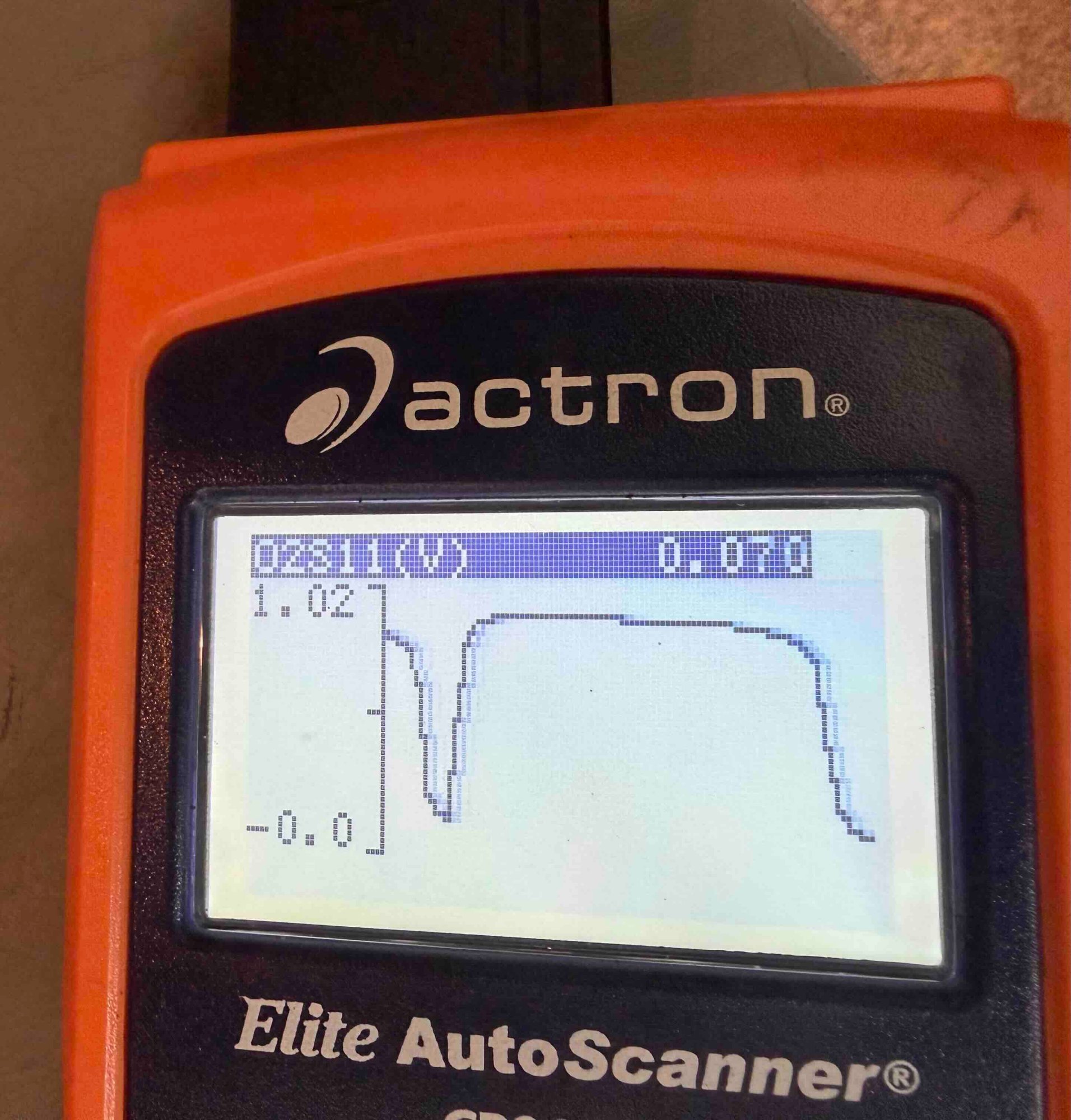

The current theory is I have a rich idle problem: A bad fuel pressure regulator, or a leaking injector(s) being the highest probabilities. I already replaced the FPR but that doesn't mean its replacement isn't also bad. It was a new part from Dorman, but the packaging looked like it had been sitting on a shelf for 20 years.
This is the (single) upstream O2 sensor shown at idle. I'm getting a lot of "rich" it seems. Sometimes it stays high like that and doesn't drop down. That makes me think it's processing injector leaks or a partially stuck open injector.

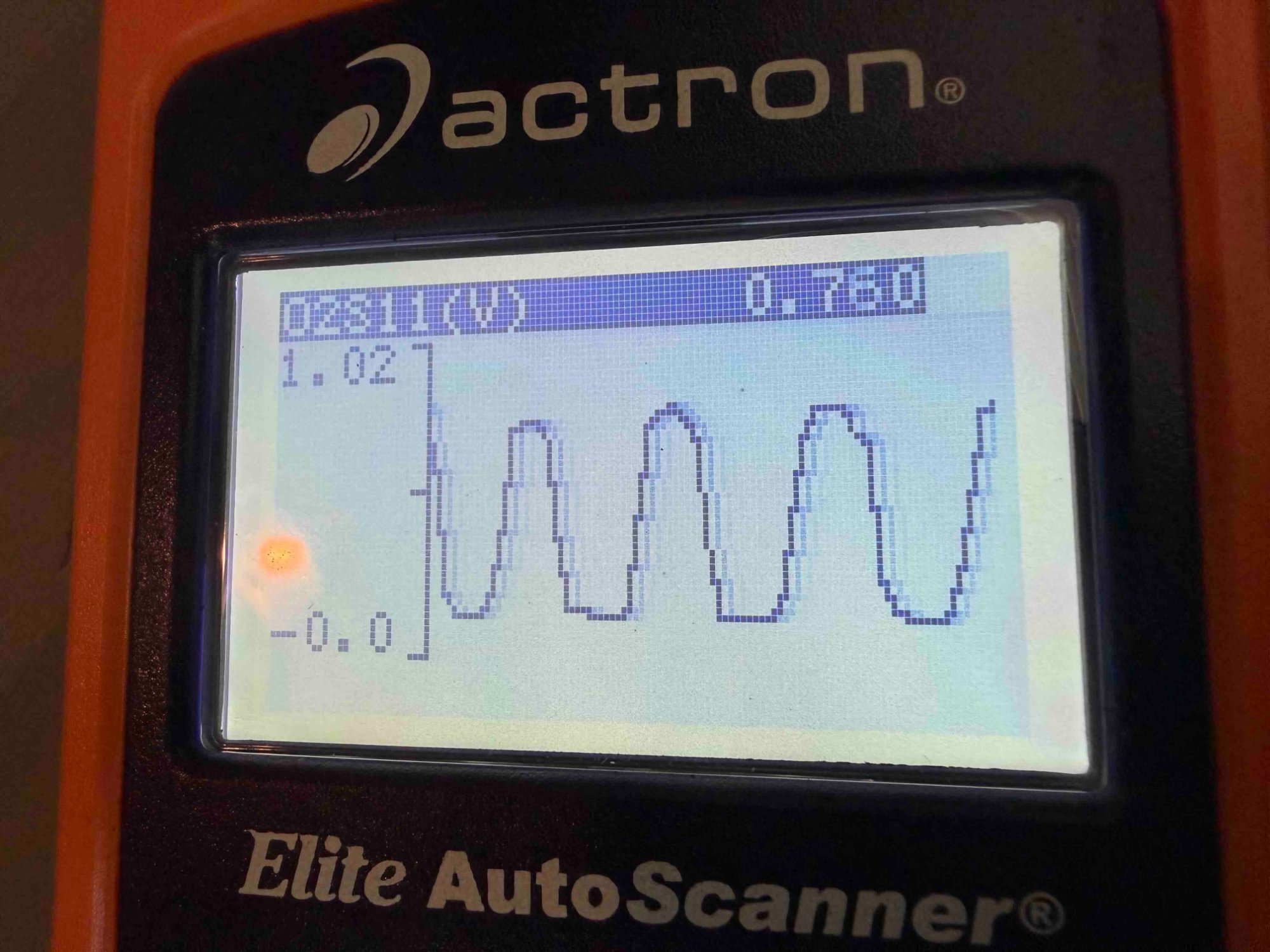

Other times it looks like this. Nice oscillations between rich and lean, which is what I think it should be. Under load and at speed, the oscillations are nice and tight and uniform looking, high and low.

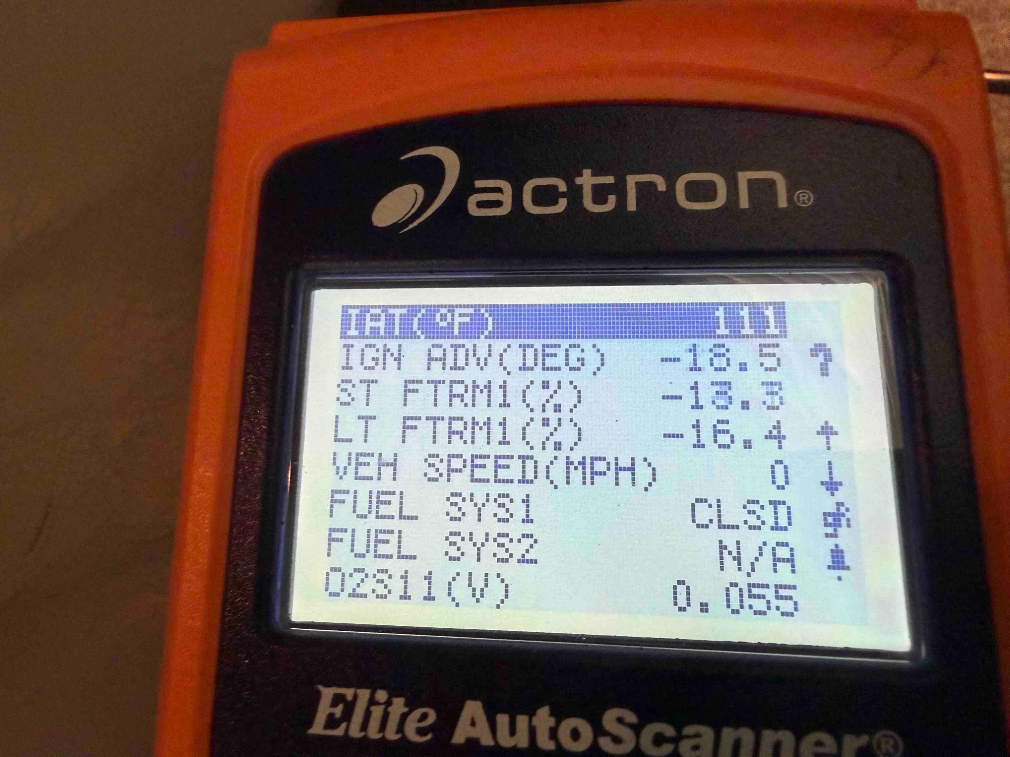

Fuel trims suggest the PCM is compensating pretty hard at idle to pull fuel out. But it's not enough to trip a CEL. Something about slowing to a stop: brake vaccum booster, EGR, or the EVAP purge is delayed, or there's pooled fuel in the intake again that's draining into a cylinder is enough to set the CEL. Of course, in two days of driving, it hasn't set. I was hoping to actually look at the freeze-frame data when it sets. IAT is high because it's idling on an 83 degree day here.
What are the conditions of this rich idle?
Warm or cold engine?
Run time?
Does every idle look like this or only sometimes?
Run time?
Fully warm, coolant temp >194, closed loop.
Run time can be anywhere from just reached operating temperature to having driven 30+ miles.
The O2 chart (which is a feature I just discovered after reading) for the bad idle seems to be "most" of the time. For the little time I've been watching it (scanning and driving! watchout!) I can't seem to isolate any cause or condition yet.
It definitely idles rougher sometimes than others and so far what I've seen is the rougher idles are always rich. But not enough to set a CEL.
