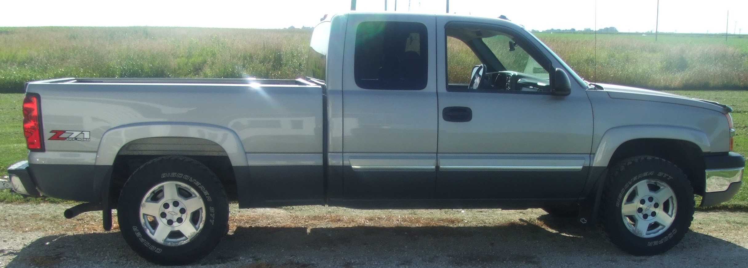

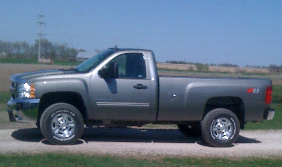

I had a 5.3L ECSB 2004 Z-71 had it tuned by diablo and it ran great got 17 mpg had all the goodies could spin the tires all day and thought it was the cats meow. That is until I bought my 2009 RCLB 2500HD 6.0L 6L90E tuned it with a diablew tune and it doesn't hold a candle to my 5.3L. I loved that truck and all it could do but all I have to say is there is no9 comparison to the two my 6.0L is faster off the line, in a roll and at higher speeds. The first thing I noticed is that the 6 is as fast from 40-60mph as it is from 80-100mph, I know this isn't comparing apples to apples, but same rear end (3.73) but different tranny and the ratios that go with them, but the 5.3 seemed to drop off big after 90mph. I just wish that my hd was as comfortable to drive as my 1500 was. Just get a 6 and don't look back!
Here is a picture of the old and then the new.
