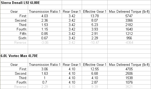

With the new lower gear ratios and wider ratio spread of the 6L80E transmission with the 3.42 gears, it puts more power to the ground than a Vortec Max 6.0 with 4.10 gears.
First gear alone the Denali deliveres 5747 lb-ft of torque to the wheels compared to the 6.0L/4.10 combo of 4705 lb-ft. Or another way to say the same thing - the Denali has 22% more grunt.
My last truck was a 6.0 w/ 4.10 gears. The Denali flat out spanks it for power, towing and fuel economy.

Nice info., thx. And it explains why the 6.2-6sp-3.4, does much better than my old 6.0-4sp-4.1. towing the same trailer, my 6.2 never goes into 6th, performs flat roads ok in 5th, does well up hills in 4th, and can if needed go to 3rd for the toughest hills, all better than the 6.0-4sp, and your graph kinda proves it. i've owned them all, including 8.1-4sp-4.1, which i thought could not be equaled, but the 6.2 holds it's own, granted it can't tow 9-11 like my 8.1 could, but furtunatly i don't need it too. any bigger than 8-9K and you'll need to step up to a diesel HD, in my opinion.

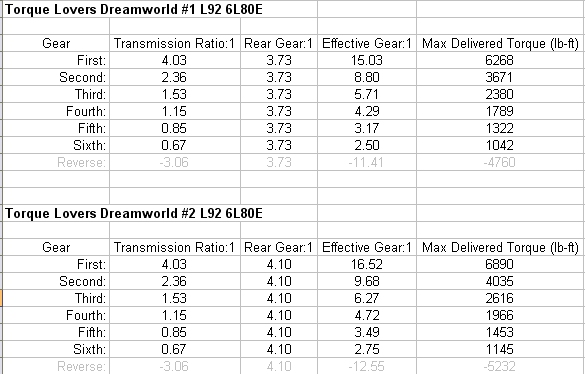

Wow....just wait until you can get a 6-spd 6.0L truck with 4.10....that would be sick.
Because of the deep gears in first on the 6L80E a 4:10 wont be available probably around a 3:73 will be the lowest.
