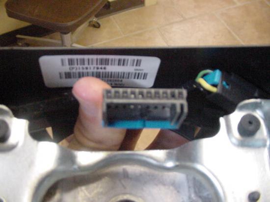

i have some pictures of what the connectors look like on a steering wheel with audio controls if this might help you, i really want steering wheel controls as well
Did you remove the steering wheel? if so, how easy was it? Any problems taking out the air bag? I should be receiving the steering wheel w/ the radio controls sometime this week and up to the dealer for installation (I'm taking it to the dealer because I'm almost 100% certain the computer has to be reprogrammed to read controls).

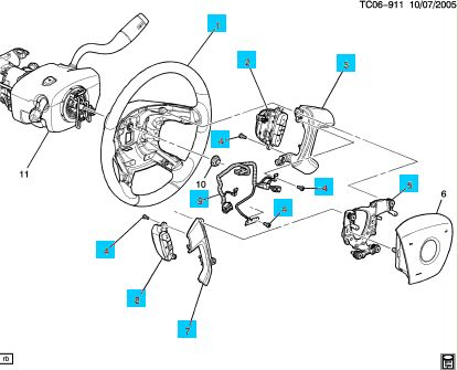

No need to remove the steering wheel to install the radio redundant control pod. All that is necessary is to remove airag by disengaging the spring locks from behind, one each side. Torx screws get removed from horn mechanism and then the pod is installed, re-assemble in the reverse order. The stock steering wheel (simulated leather) has all necessary attributes including the plug termination to radio. No re-programming is necessary unless something changed after mid year 2007 that I haven't come across. If you need any more information just let me know.

Just want to link this post to your other post Steve, because it looks like you posted instructions for this. http://www.gm-trucks.com/forums/index.php?showtopic=69369

TIGHT! Now all we need is a part number! Anyone here with the controls willing to contact GMPartsDirect.com and have them look up the number for the part?
