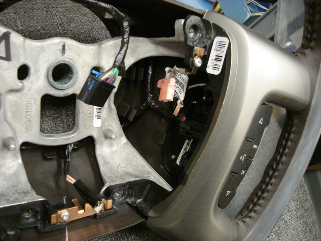

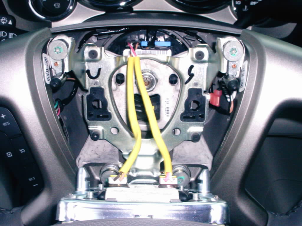

OK, I did a little looking around at old parts today trying to remember what was what. Here are a few photo's of how the wiring harness is mounted as well as what it looks like out of the wheel. Please keep in mind that these wheels may not necessarily reflect the exact same unit you have, it is all based upon trim level and options ordered. Couple of part numbers on this harness, I'd check them both. They are: 28050229 and Z49480229.
Here's a few photos of how it is routed in the wheel.
