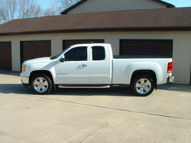

UNDOUBTEDLY! Send me a nice profile shot of your truck and I'll p'shop 'em off so you can see how right I am.
Alright...here ya go!
http://s307.photobucket.com/albums/nn310/2...¤t=DSCF0482.jpg

Damn You! Those are going to have to come off!
