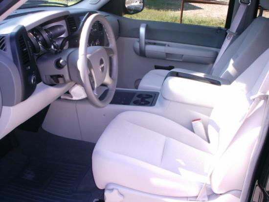

another good pic of interior with new console
How do you attached pictures? Anyways, great job on the console it looks awesome. How much did you pay for it? My next mod is adding the XM module to the radio, after that I need to chill wife is getting a little bit pissed;) Althought I need to find how to do the fog lights upgrade.
i paid only 200 for the console, i sold my center seat for 300, so i ended up making money
Where did you get the console from? do you know the part number?
i got it on ebay from a guy in austin, tx, he was a really cool guy, a console like mine is on ebay right now for $230 plus shipping, i bet you can talk him into $300 shipped to your door though
