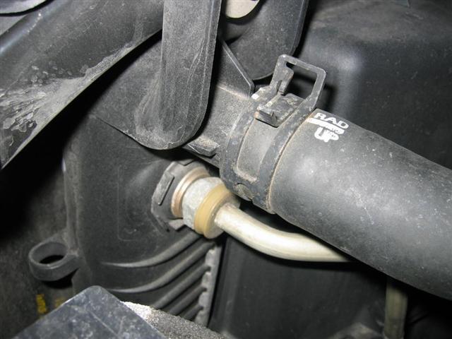

I am getting my coolant flushed tomorrow and I have had a slight leak. I topped off the coolant this morning and I noticed the leak again. It looks to be coming from a hardline that goes into the radiator right below the upper radiator hose and at the bottom of the radiator on the driver side that heads to the back fo the engine. Any idea of what this line is? I think the part that is leaking at the rubber hose where it has a fitting going form the hardline to the back of the raditor to another hardline below the engine. Both lines are wet so I am sure they are both leaking. There is "orangish-redish" fluid at both fitting locations so I am guessing that it is coolant from this line especially since it started leaking again after I filled up the reservoir. Any help would be great. Thanks.
Are you talking about the metal lines with screw in fittings that thread into the radiator? If so those are transmission cooler lines. Other than hoses that should be all you have attached to the radiator...
Anybody else?
Yeah there transmission cooling lines (hard lines) if there leaking then its trans fluid. But on the other hand there maybe a small hole or crack in the radiator and the antifreeze is running down to them. Hard to say since we cant see it.
Thanks guys. I found out that they are the tranny lines and they run through the radiator before the tranny cooler to help out. I looked further into it and smelled the liquid that was leaking and it is antifreeze. I took the "air dam" type skid plate off and the actual skid plate off and you can see that gasket has failed on the water pump and it is leaking and dripping down the engine. Looks like I have something to do this weekend. :uhoh:

Is this correct? I thought the lines entering the top and bottom of the radiator on the drivers side are engine oil cooling lines. The transmission cooling lines are smaller OD and enter the passenger side of the radiator, connecting to the aux cooler located behind the grill. I just want to make sure we are identifying the lines correctly.
Here are a few pics to help identify:
Upper drivers side
Lower Drivers side
Leaking rubber hoses in the line (I need to replace) located below the stearing gear box.
