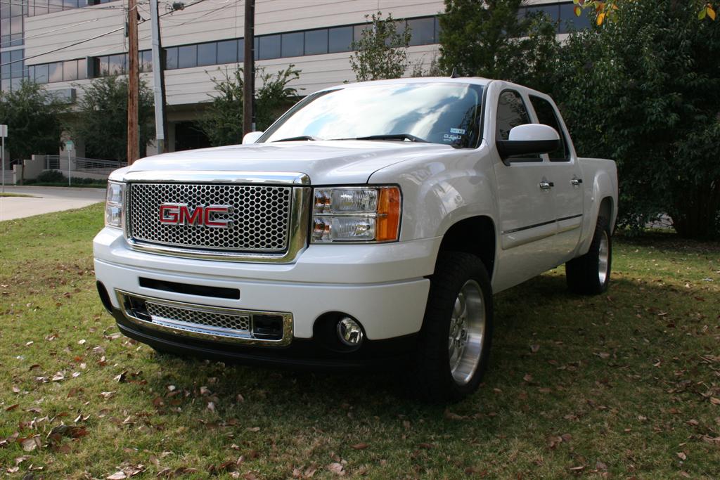

Here are some pics after debadging, removing the front plate bracket and polishing with my favorite polymer-based product. It took about an hour to remove the badging on both doors and the tailgate. The current trim tape (black, thin) comes off alot easier then what GM was using in 99 (white, thick). No heat necessary, just used fishing line to "cut" the letters off, roll the foam tape off with your finger and clean residue. I cleaned the residue first with simple green which removes alot of it and used goof off to get the few tough spots removed. Cleaned with detail spray and polished.
Nice clean look.
I always take off the cr$#py dealer emblem but leave the other ones. I am not going to give them free advertising. :( Plus they always put it in a place where it detracts from the look.

Agreed. I quickly peeled the 3"x4" sticker my dealer put on the tailgate.
Nice rig, Lincoln. I thought about debadging my doors, but since I don't have door moldings, it would probably look too plain.
I'd like the look without mouldings but I need them since I don't have great parking at my office. I would like mouldings without the chrome strip but I haven't looked into the cost of getting the mouldings for a regular Sierra Crew Cab yet.
