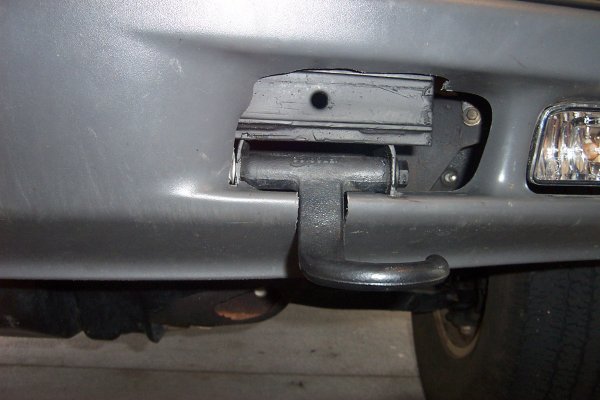

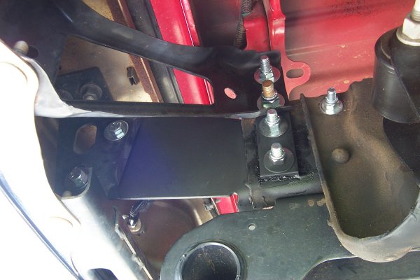

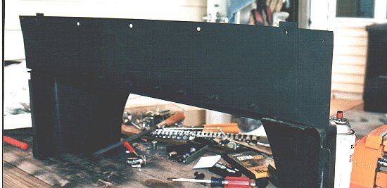

I don't know how similar your truck would be to my '99, but it wasn't hard on mine at all. I've had a Performance Accessories B/L on my truck for almost 6 years now and have had no problems whatsover with it. For the tow hooks, you can flip them, but they will not line up properly to be able to put both sets of bolts it. For me, it was more important for them to be secure if I needed to use them. Your 2006 may have a different tow hook mounting system than mine too, I don't know. You can easily cut notches in the plastic airdam and make it look good. Just take your time and think ot what you want to do. I've seen others that butcher it up pretty good and it does look worse. I cut the metal loops off of the frame that normally stick out in to the empty space behind the bumper. You can see where they used to be in the close-up pictures of the tow hooks. You can also see the loops still in place in the pic of my friend trimming up some tabs on the frame. No cables or lines were streched on mine. I did snap the hard brake lines out of the plastic holders on the drivers side frame rail (which the instructions said to do). I couldn't justify the cost of a suspension lift and the right size tires to go with it. I only wanted to run 33's, and I knew I could have without a B/L, but still wanted it to be a little taller. The lift cost me just over $200 from JC whitney (after using one of their coupons on the cover), the gap guards were $50 and me, my brother and a couple friends installed in in a day at the cost of a couple pizzas and some beer. :D

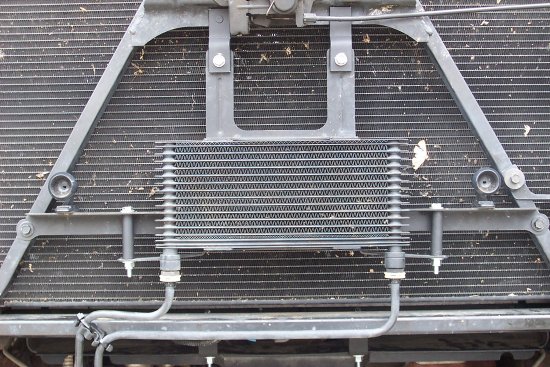

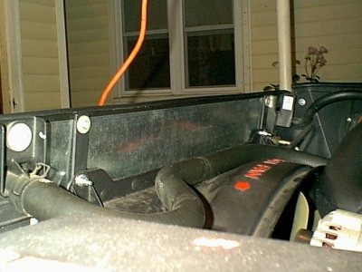

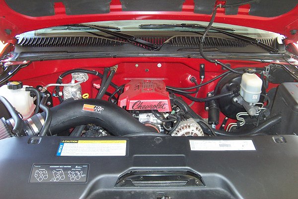

The Performance Accessories kit for mine came with very good insrtuctions and and everything needed except the gap guards. I did cause the radiator to look weired since it was lifted, but the engine wasn't. I bought some thin sheet metal at Lowes and dressed it up a little better. It wasn't having any cooling problems before doing this, but I know it couldn't hurt it either. I don't remember how long after I put the B/L on until I added the sheet metal to the radiator, but it was quite a while after and there has never been any cooling problems.

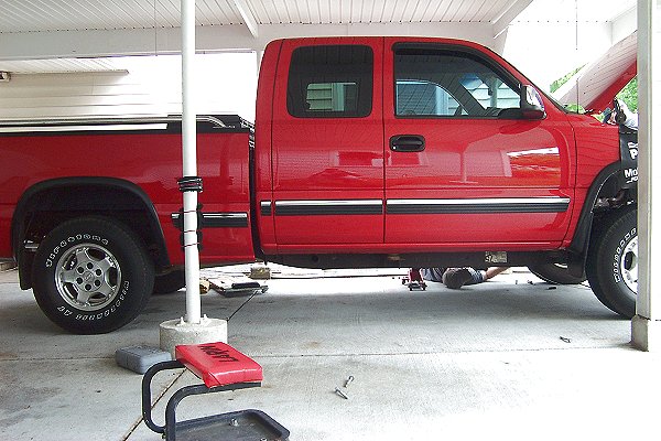

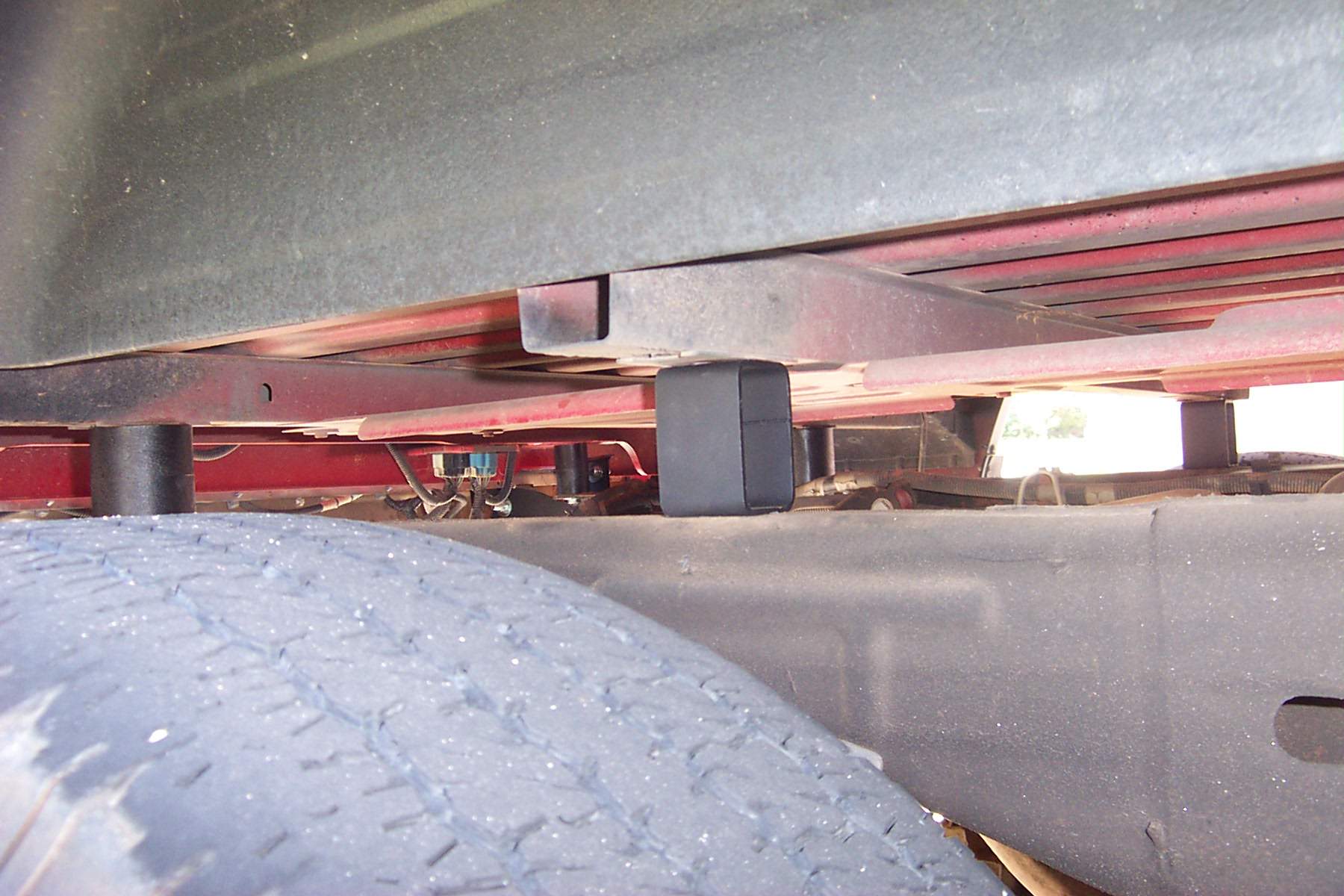

I threw a few other random shots in there. I always thought the picture of the cab lifted and the bed not lifted looked funny.

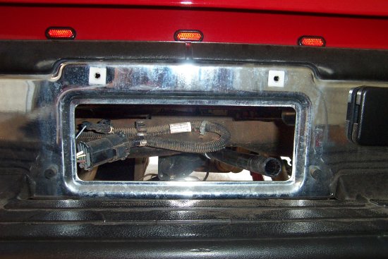

hey tom! i was just wondering if you have any tail end pictures, i'd like to see what the hitch and everything looks like! i've been thinking about just going with a 2" body lift and all of your info has pretty much stomped out any of the doubt i had about them!

If everybody did their body lift as nicely as yours they wouldn't have any problems. The fan shroud mod is a good idea.
