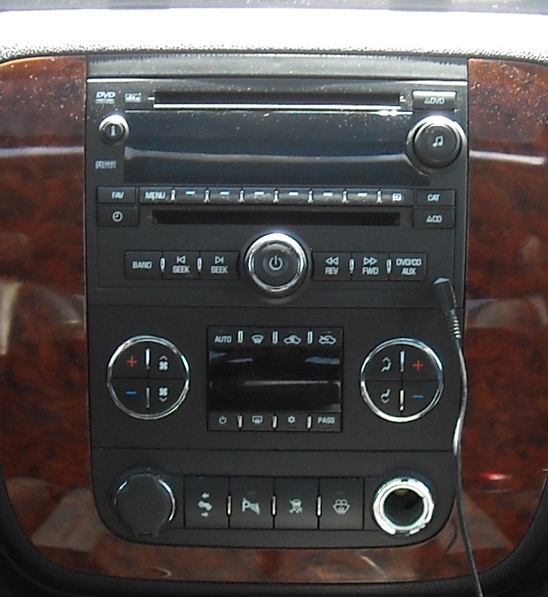

Just my thoughts on the subject, since I am Gen 7 originally, I think I am just screwed for Onstar
Given that there are proven cases of vehicles with Gen 7 modules regaining working OnStar after installing the Gen 8 modules, I can't agree with you. :cheers:
I agree with Charlie......since we have 07 GMT900 vehicles out there as examples with working Gen8 On* VCIM's.
We have too many upgraded VCIM vehicles with partial On* functionality now to give up before we conquer this issue.
We're not that far off.
I hope that is true but I cannot expend any more time on it and must rely on others to find the solution which is why I dropped this information. I am working on updating to 2009 magnetic ride control from 2007 electronic ride control which is more intricate and affects the BCM and XBCM software as well as wiring, so I am going to concentrate my efforts in that area. What I have learned through this process is that I might have been better off just buying a 2009 with magnetic ride control and bluetooth already installed. It definitely seems to me that the owners of these vehicles (2007-2008) have more interest and loyalty to their vehicles than the engineers that designed the software/hardware for them and refuse to offer solutions that we all know are technically achievable.
My problem is that as much as I like the additional features like Bluetooth, USB, etc. there are other features that have been changed or eliminated in the newer trucks that I don't want to give up. Plus it's just plain fun to mess with this kind of stuff no matter how frustrating it can sometimes also be.
Yup, sure is just plain fun!
On a side comment, I have the BT VCIM in my hands, and am now wanting to upgrade to the OEM nav. I've got the 6 disk Bose system now. I think I saw in one of your other posts to another member to "save yourself some trouble and get a nav from an '09-'10" or close to that. Really? If I can get a '07 or '08 nav wouldn't that be ok? I know I won't have usb, but is there something else?
Thanks
In your case, David, any GMT900 NAV unit will work fine. I actually did the exact same swap in my truck (6 disc to NAV) and it was no big deal. The unit I used was a 2009, but that's really immaterial to a successful swap. The 2009 units do have XM Nav-Traffic capability, but that doesn't work in an 07-08 without also swapping the XM tuner module (which I haven't done).
I'm now upgrading to a 2010 NAV with the USB, so I'll be selling the 2009 unit I have now. Keep an eye on the For Sale section, I'll be posting it within the next couple of days. First to message me/reply once I make the thread gets it for a pretty good price. :)
RE: NAV upgrade
But if I have an '07 with DVD and CD, when I upgrade to NAV don't I loose the ability to have a CD & DVD running at the same time? Also, don't you have to have the NAV CD installed for it to operate?
RE: NAV upgrade
Not if you have the rear seat entertainment package, as far as I know. Or you can use a lockpick.
Yes. There is a separate slot behind the nav screen specifically for the map disc, so you still have the main slot for audio CDs and/or DVDs.
