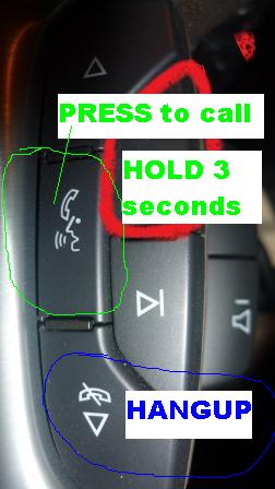

Just to be sure we are talkign the same buttons ....
Mine works using the steering wheel button. The same one that would mute the radio if not held down. I hold the button for two seconds and then it says 'ready' . Then I say 'bluetooth' and it goes into the bluetooth menu.

:thumbs::D:sigh: just installed my ebay obtained 20783877 vcim in my 07 avalanche with nav...can not get my bluetooth working, hold down voice button try saying bluetooth and not recognized. tried the mirror phone button "on* ready" tried "bluetooth "....not recognized....i looked at my old onstar module and it was labeled 06 version, is there something else thats not compatable? this must have been built in 06 but is a new body style 07 any help would be welcomed.
Do you have the steering wheel audio controls on the right side of the wheel? They don't have to have the phone receiver icon, but you must have the physical buttons on the wheel for BT VCIM to function.
