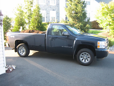

What do you guys think? Am I pushing the half ton to much around the yard? Or would some helper springs do the trick just fine. The truck has plenty of power and I don't often haul this. Thanks
helper springs or air bags will help. but i dont think your working the truck to hard! Next time we put 4000lbs in the bed of our work truck I will take a pic for ya (and its a 1500) to see overloaded.
I don't think you are working it too hard at all. I used to carry full loads of topsoil or gravel when I had the Z71, and it rode fine. Your truck looks pretty good all loaded up, and working for a living.
Oh heck, you're okay with that sort of load. If you do haul that much quite often, some helper springs would help.
I should have taken some pictures of my Tahoe when I hauled a load of paving stones home from Rona. She was really riding low that day.
It doesn't look that bad. If you hauled that much every day or on a regular basis then I would do something. The only thing I would do is drive a little easier and make sure your tires are properly inflated when hauling heavy loads. Otherwise nice pics!
you should be fine, unless you are hauling a pallet of sod like that other guy was with his GMT900 truck
You'll be fine. That is the reason I sold my HD CC, wasn't using it enough, and I pull a 25' TT.
I have AirLift Air helpers, love them. I had the RideRites on my last 2 HDs, they are great too.

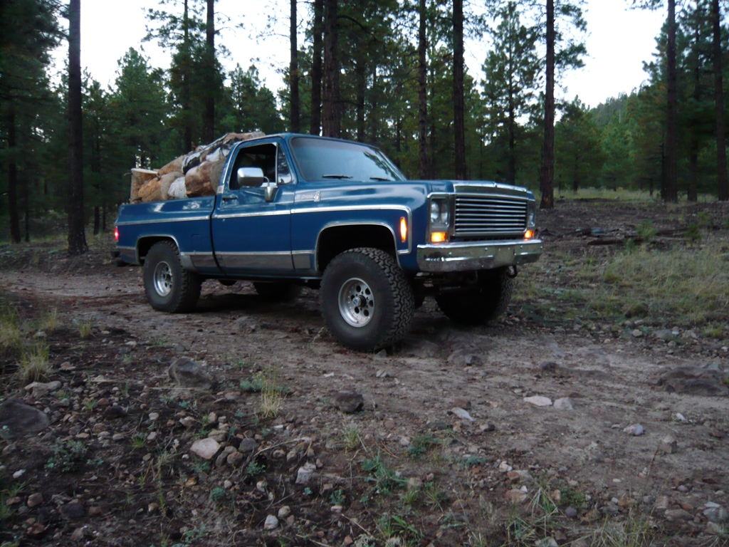

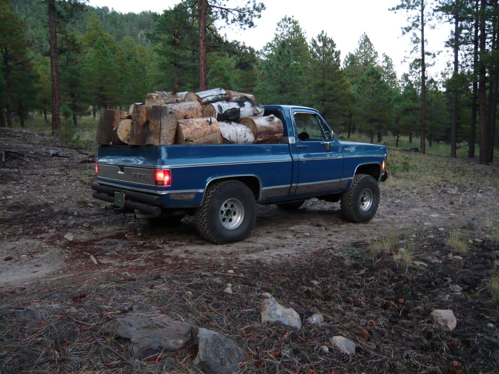

Same here I had a extracab 2500HD D-MAX, but most of your firewood weight is pass the rear axle making your truck sit down more due to leverage. If you had the weight more even in the bed it wouldnt be squating that much.
Without the 2.5" lift blocks (to fit the 35's) she would have been past the bump stops. With a load like this my truck finally rides better than a covered wagon. Still running the stock springs from 1979. Oh yes!
I'm actually on a decline so it is squatting more than it looks.

IMO it's ok to overload a 1/2 ton periodically, if it's an everyday occurrence and you cover miles, then I think it's time for an HD. I added Ride Rite air bags to my GMT900 because I found I didn't have enough clearance when loaded. I see you're also working offroad, so that might help. The bags add 50lbs of load capacity for each psi. I hauled 2100 lbs of stone to a site with 20 psi in the bags and it rode like stock. I wouldn't do it daily, but it's nice to have the savings of a 1/2 ton daily and the higher capacity only a few psi away when I need it.
Added image: AirRides with 20psi and 2 yards of damp top soil
Thanks for the replys. I will have to start looking into getting some helper spring or air bags. Which is the most cost effecient for my application? You guys work your trucks harder then me haha. Thanks
