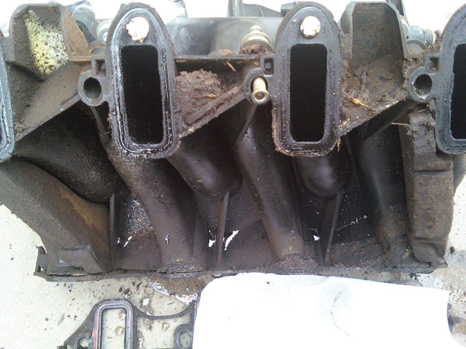

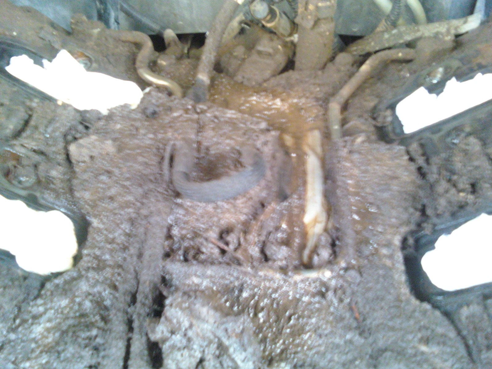

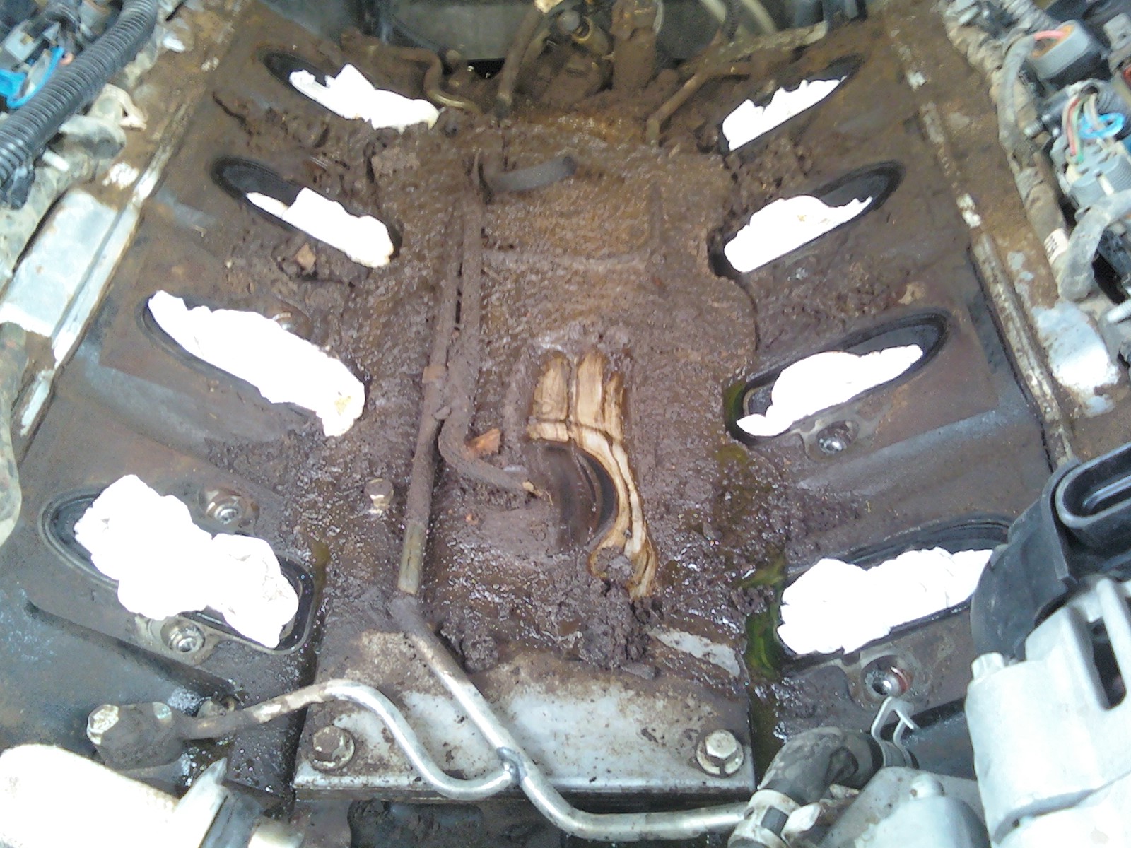

so finally changed them out. Kinda hard job but the pics will show you why. 1st knock sensor was in water and looked shitty, 2nd ks was in water and just non existant and couldnt even come out with the hex, i had to shell it and drill into the stud and easy-out bit it. Wow wat a p.i.t.a. to do that :lol: .
But results are WAY better gas mileage, and surprisingly a very noticeable performance gain.
sooo rule of thumb CHANGE YOU KNOCK SENSORS!!

wow!! What a mess!
Havn't removed mine yet but, when I do I hope it won't look like that! I'll probably remove that useless foam piece they put on both ends of the intake. Once mine are back in, I'll have it sealed up so spraying water over that area won't be an issue. Curious what your sensors looked like though! Post a pic if you have a pic! :lol:
Wow! You surely needed to do that servicing! I hope others look at this and realize it's likely time! :dunno:
